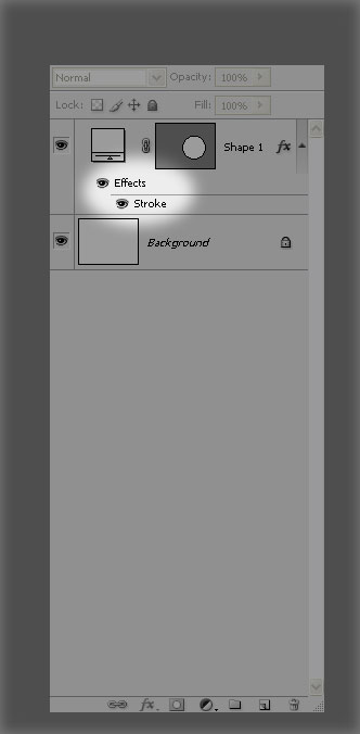

Do you mean the stroke width? It depends on what you used to put the stroke on it. If everything is pixellated, you are going to have to do a lot of work. But if the circle exists as a shape layer and you applied a stroke to it using the Layer Styles dialog box, then that stroke is "live", meaning you can go back to the Layer Styles dialog and change the properties of the stroke.
So I'd need to know more about the circle to tell you how to modify its stroke width.
by: casinnolaPosted on 2009-09-21 at 09:21:59ID: 25384564
To quickly know if the stroke is "live", look at your Layers panel. Do you see "Effects" and "Stroke" beneath the circle's layer? (See screen shot below.)
by: casinnolaPosted on 2009-09-21 at 09:26:17ID: 25384599
I just noticed this is posted in the Illustrator section. We're talking about a shape Photoshop though, right?
by: codequestPosted on 2009-09-23 at 08:11:34ID: 25404056
Thanks for input.  I'm learning a lot about Photoshop..."it's all done with layers"...the "graphics drawing program" metaphor does not work AT ALL!   Your answer prompted me to discover the Layer Style > Stroke option, solved problem.
