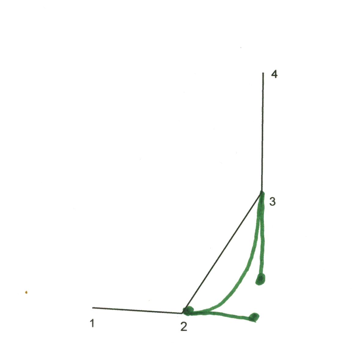

I have a path of four points. I want to get handles as illustrated in green in the picture. I dont want to change the part from point 1 to point 2. I dont want to change the part from point 3 to point 4. I only want to change the part from point 2 to 3.
How can i do this?

Sunsales,
It's been a while since I used Freehand and I don't have it installed anymore but try this:
Use the convert tool to get the handles for points two and three. Now, select the handles between 1&2 and 3&4. Delete those handles and it should snap back to a straight line between those points.

by: SunsalesPosted on 2008-09-15 at 14:55:40ID: 22483296
convert tool? I cant find that tool. Deleting handles? I have either 0, 1 or 2 handles for every point - and i really dont know how to make it 0, 1 or 2. - but deleting a handle i cant get, if i try the whole point delets to...

Now that I'm at work where I have Freehand installed...
Basically, all you need to do is grab the direct select tool, (the arrow with a white fill, not the black one.) and click on a point. Click on the same point again (it may take two times, what you want is for that point to "turn clear" indicating that it is selected) and drag in the direction you want the handle to go. That should pull out the handle in only one direction and you don't need to go through all the other steps.
I'm using Freehand 11. If this doesn't work, post and I'll open an older version.
Best,
MH
