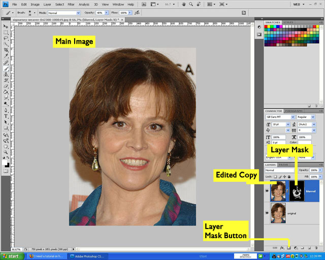

by: sledgePosted on 2009-01-11 at 20:52:00ID: 23351191
I do exactly the same as  D brugge.
1. Open the picture you want to work on.
2. Make a copy of that image
3. Make your changes to that copied image.( in my attached pic I've called it blurred but you make whatever adjustments you need to this layer)
4. With the adjusted layer active click on 'layer mask' button.
5. With your foreground color set to black and the layer mask selected, use paint bucket to fill the main picture. (you should see all your adjustments disappear)
6.Choose your brush tool and change your foreground color to white. Use a soft brush with opacity set to about 40%
7.With the layer mask still active start brushing in the areas you want to smooth.
You will notice your adjusted layer starting to show through the main picture.
As D brugge says, If you find that you have have brushed too much of the edited picture through, just change you brush color to black and start brushing the edited layer away again.
