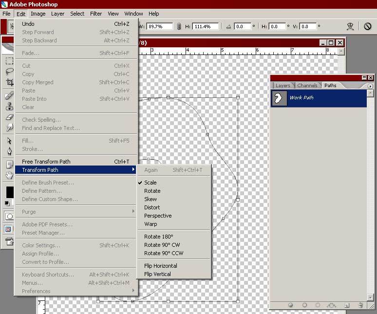

by: statler01Posted on 2009-05-29 at 08:55:28ID: 24503684
Scaling paths (which are vector art) in Photoshop:
When you create your path, make sure it's a path and not a shape layer (image 1)
Select your path in the paths pallette then transform it. Notice the transform menu says path instead of image or layer.
Fill your path: create a new layer, then open the shapes pallette and right click the path, select "fill path" (image 3)
Click the trash can on the paths pallette to delete the path. That will get rid of the "jagged" edges. (they aren't really jagged, you're just seeing your path around your rasterized fill, which makes it look jagged)
NOTE: You could also do a shape layer, which will allow you to retain the path along with the fill. The fill is bound to the path allowing you to scale it later. This is *probably* a better method for what you're doing. The part noted above is my *possibly inefficient* workflow. :-)
