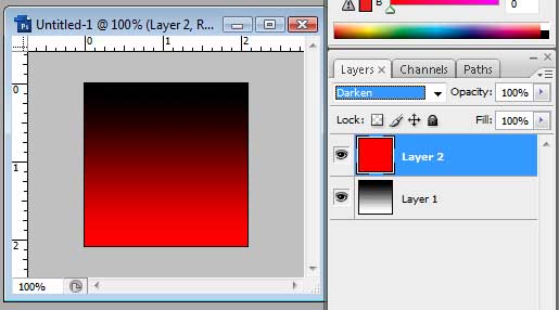

You mentioned wanting to colorize the red background...  You could try this: click layer-->new layer. Set the foreground color to red, then use the paintcan to fill the layer red. Now, set the layer mode to "darken" (see the attached image for help).
If you don't like the color you get from that layer, you can then use the hue/saturation dialog box (see the first method above) with the red layer selected to make adjustments.

    Layer mode set to darken
