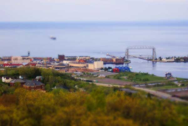

    • 15 KB
    Original
    Original

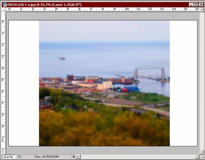

    • 4 KB
    White layer, area selected to cut

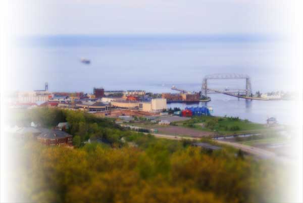

    • 27 KB
    With gaussian blur. (Use the preview to determine how much blur to use)

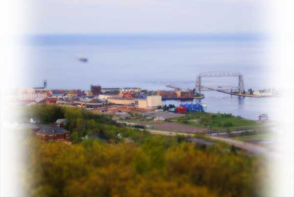

    • 14 KB
    Finished - I wanted to show more image, so I selected and moved the white edges a bit after the blur step.

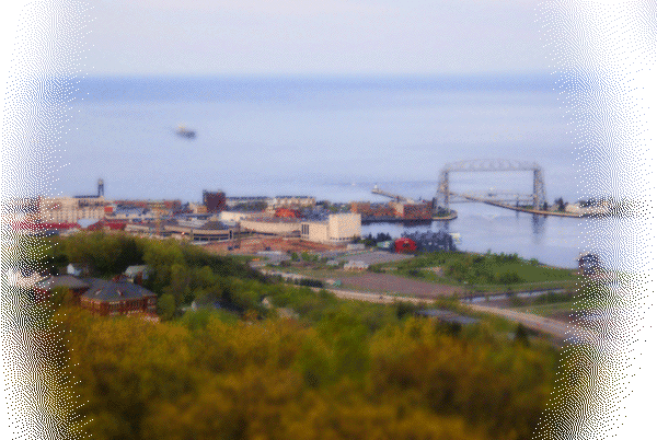

With the above, this would be the results by making a layer mask, and painting the edges with black, and bringing the edges in a bit (so as to not have a perfectly straight line) then applying a gaussian blur to the mask.
Saved as PNG with diffusion transparency dither.
