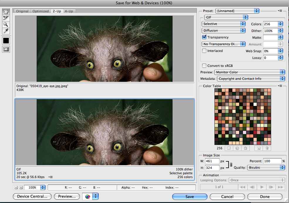

by: Philip_SparkPosted on 2009-08-30 at 11:06:07ID: 25218537
Your best bet is to use the save for web feature
that way you can give yourself a 2 up comparison of what you're doing.
Just adjust your various options and get instant visual feedback
version shown is cs4, but cs3 etc. will be similar

by: BongSooPosted on 2009-08-31 at 08:49:50ID: 25223756
>without actually compromising with the quality
The key here is this statement. You will not be able to achieve any reduction of the file size without compromising on quality. What you need to determine is how much you can compromise. JPEG is a COMPRESSION (ie, lossy, ie, you will lose quality) format for reducing the file size. The degree of compression can be adjusted, allowing a selectable tradeoff between storage size and image quality. JPEG typically achieves 10:1 compression with little perceptible loss in image quality.
So what you need to do is decide how much quality you can lose, than follow one of the above recommendations for achieving it (I often use the four up version of the feature Philip recommended).
