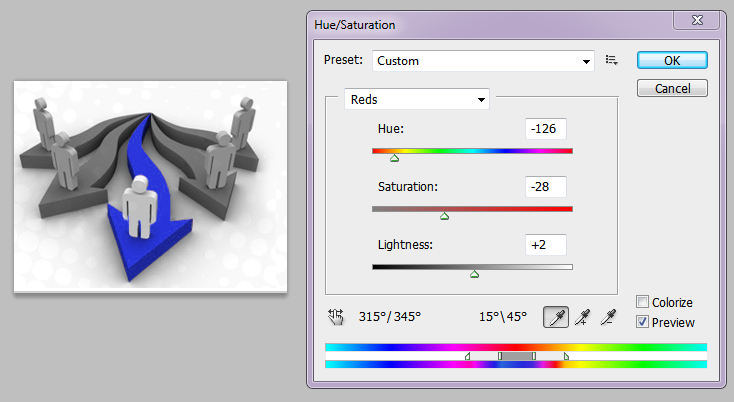

how do i change the red in this image to blue?
Asked by: Black_Dog_Design
i just want to change the red in this image to blue - how would i do that - i have never used photoshop before. I have cs3

by: exalkoniumPosted on 2009-10-02 at 07:08:54ID: 25478028
I do this through Image > Adjustments > Hue/Saturation. You just have to make sure to select the Reds colors:
by: Black_Dog_DesignPosted on 2009-10-02 at 07:26:00ID: 31636381
thank you - that worked perfect - how can i create a certain hex color? i can ask this as a separate question if you'd like.
by: SheharyaarSaahilPosted on 2009-10-02 at 07:32:06ID: 25478252
i do it this way......
Image>Adjustments>Channel Mixer
Sleect RED channel, and set the Red to 0% and Blue to 100%
then select BLUE channel, and set Red to 100% and Blue to 0%
