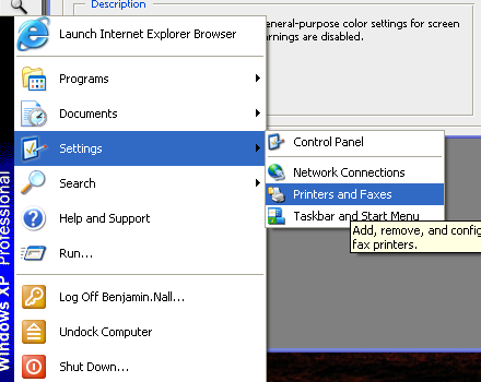

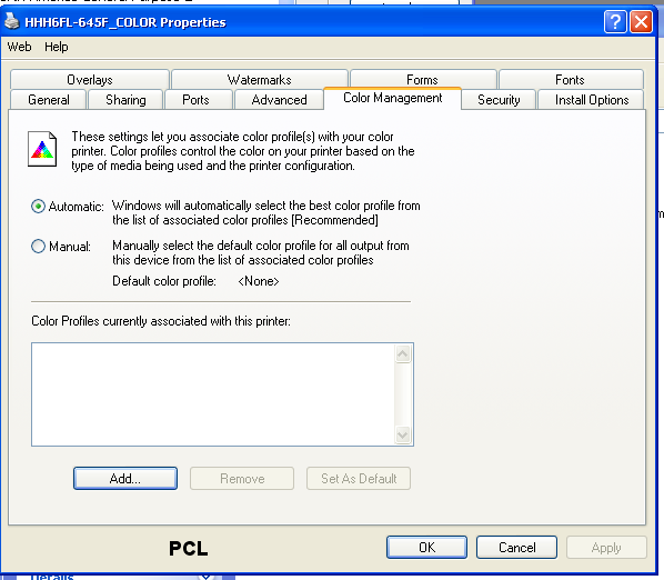

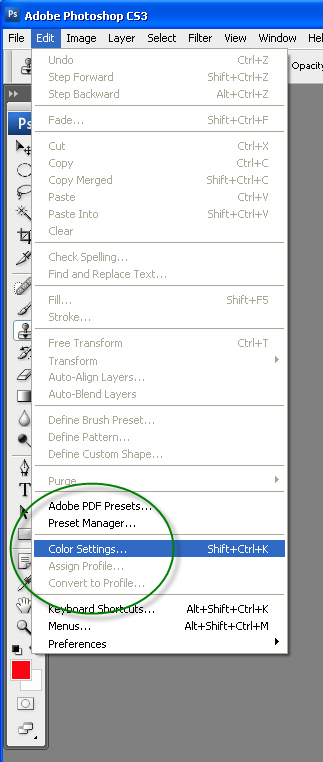

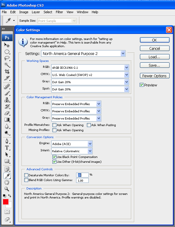

I would start here: check photoshop color settings and your printer settings and see what they say.
