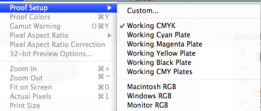

another problem i am having is the image looking perfect on my 24"mac but when i look at  a standard monitior/laptop the pics are alot darker! is there a tool of some sort that i can use to predict how a pic will look? other than hooking up a 2nd monitor beside me?

by: Philip_SparkPosted on 2009-08-07 at 15:08:12ID: 25047301
USe the proof set up to preview how it might look on windows, see screenshot
by: meteorelecPosted on 2009-08-11 at 02:07:42ID: 25067183
thanks guys, all good advice!
