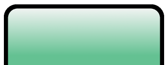

by: brundoPosted on 2008-09-19 at 01:52:45ID: 22518992
did you try the recipe?
If you have problems with gradient (e.g. look at your white pixels in corners), let me know. It is very easy to make tabs like attached one :-)) In last answer I wanted to give you solution to your problem/question, but I think it is easier to start from scratch to avoid problems in step 4.
