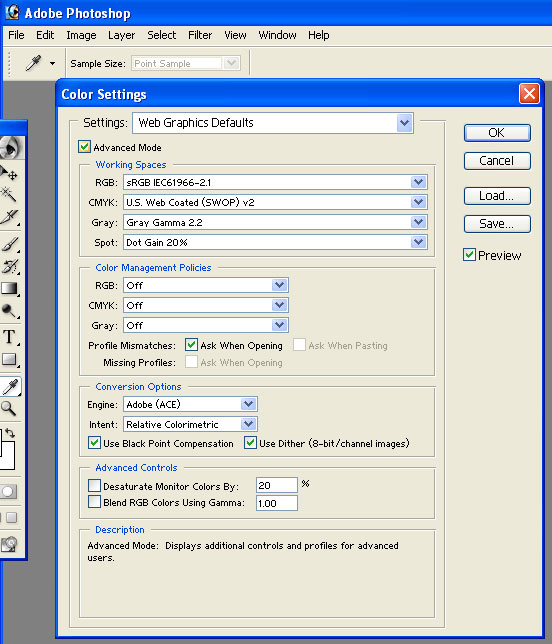

by: BongSooPosted on 2008-12-30 at 09:46:40ID: 23264344
Check your color settings and make sure that Photoshop is not adjusting for your monitor under the advanced settings. Also, make sure that your working spaces are the same as in the other programs.
