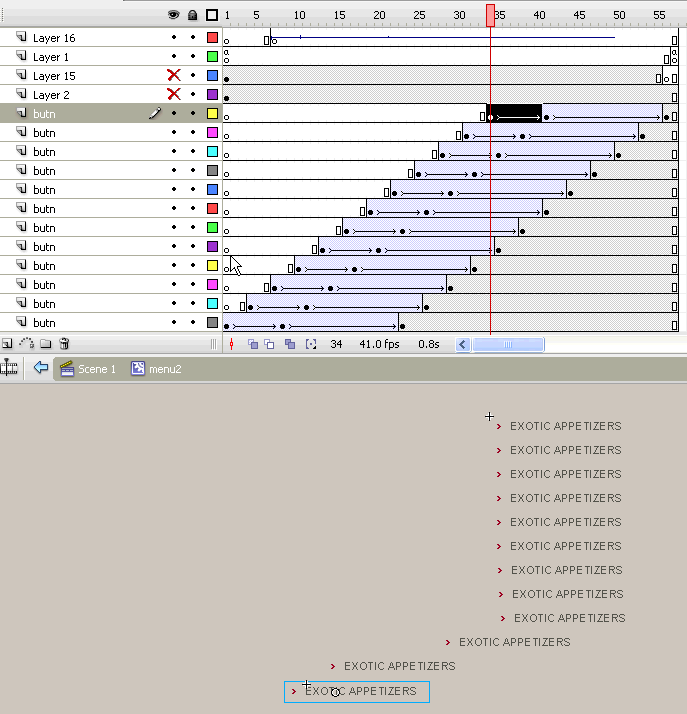

Maybe I did not state my question correctly.
The tempalte I am editing has a Layer called 'menu2', when I double click that layer to open it up it shows all the different buttons in the menu, there are 12 of them.
(See Snap1)
When I click on the first menu option and then press F9 I see a window with a tab called 'Action - Movie Clip.
(See Snap2)
Note: Is it strange to anyone that there are 36 (12 x 3) butn items listed in menu2?
Anyway, where do I add, change, edit the action script code (see below)
onClipEvent (load) {
      num = 1;
on (rollOver) {
      this.gotoAndPlay("s1");
on (releaseOutside, rollOut) {
      this.gotoAndPlay("s2");
So that each button, when clicked, will redirect the user to the correct internal page or external web site?
Thanks!
