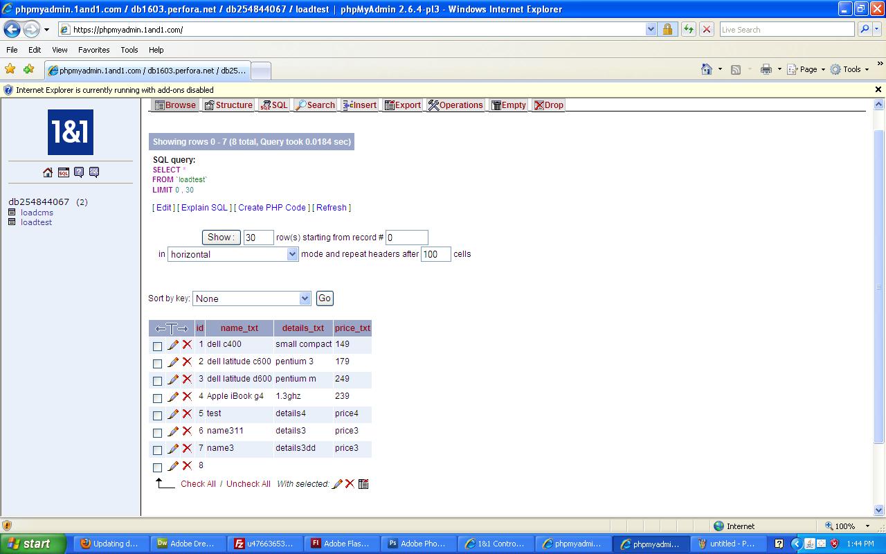

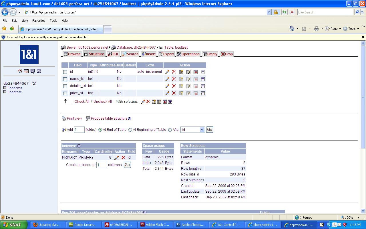

Currently as I stated from the beginning, all i have is the part where my data loads into flash , and each entry from the database is loaded into its own movie clip.  It is displayed in flash this way..
-----(here is a working preview of how the data loads)
http://previewsample.com/loaddatacms
What I am trying to do is edit/update one of the entries that you see.  Obviously there are multiple entries in the data base, so we would need to pick one of those entries and then be able to update it.
For learning purposes, i was just trying to keep it simple and follow what you are trying to do.
But the main objective is to be able to update data.  so if you have a simple way to do it that is different from the way I load the data in, then that will work ;)
but i think that once i can see it actually working , and the code that makes it work, i can take it and integrate it with my above file.
hope that makes sense. ?
I attached screenshots of the table and the contents..
and here is the username/password/table info if you can get in someway with this?
$connect = mysql_connect("db1603.perfora.net", "dbo254844067", "Q77hasTT");
mysql_select_db("db254844067", $connect);
    • 118 KB
    SCREENSHOT OF THE CONTENTS IN THE TABLE
    • 142 KB
    SCREENSHOT OF THE TABLE AND ROWS. ETC

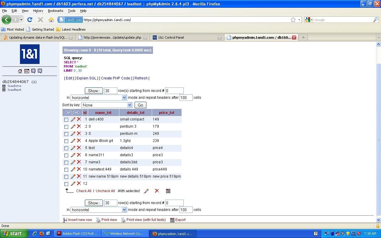

by: sam928Posted on 2009-09-24 at 04:40:38ID: 25412185
good morning crooksy88.. i have checked the table and it has not updated.. instead it filled the field with '0'
i attached a picture.
i dont know if you have seen it or not. but 6 posts before this one please see my comments and the updated file.  I have made a flash form that inserts new records and also you can see the data that is there...
please find the link above (6 posts before this one, and the messages from 'andoneknight')
i have also tried your form and it does not update the data, it just replaces it with a '0' in the 'name_txt' field.
    • 129 KB
    screenshot of data.. not updating .. Notice the '0' in the 'name_txt' fields
by: crooksy88Posted on 2009-09-24 at 04:47:49ID: 25412234
I've just used your form to add a record. Has it been inserted?
by: sam928Posted on 2009-09-24 at 09:32:30ID: 25415169
yes it has been inserted. you can view all the data by clicking on but 'VIEW DATA' button directly below the form where you inserted the new record.
http://previewsample.com/loadupdate
also here is the source
http://previewsample.com/loadupdate/loadupdate.fla
by: crooksy88Posted on 2009-09-24 at 09:50:21ID: 25415330
Your form is working now.
2 issues that I changed.
1. You had two forms both with the same instance name 'panel_mc'
2. Your URL to update.php was incorrect.You had /loadupdate/ when it should have been /LoadUpdate/
The fla is on your FTP server... loadupdate2.fla.
PS. remember to change your database and ftp login settings as you have posted them on this question.
You might want to request this question be deleted.
by: sam928Posted on 2009-09-24 at 10:47:00ID: 25415841
which form are you referring to that is working?  because the 'insert new record' form was working already...  but i just tried updating a record again with your 'update' form but it still did not update. ??
also, the .fla you uploaded on the server was no good.. i tried to open it and it said ''unexpected file format''
by: crooksy88Posted on 2009-09-24 at 10:52:48ID: 25415899
It is working, you just need to set the form to do something once the response has been received.
I've set it up now to jump to frame 2 so you can see the results.
I've just updated record 16.
