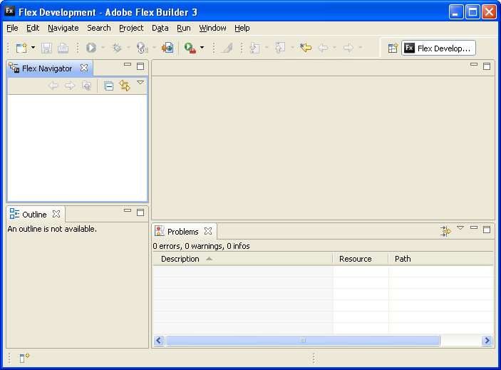

by: HardiPosted on 2008-08-26 at 00:03:39ID: 22312242
I'm probably just stupid... I can't see how those links can help me start using Flex Builder or Flash Develop.
The first 2 links give some code snippets, but in my Flex Builder and Flash Develop there is nowhere to type in code.
The third link is AS3, I can type those in Flash CS3 by pressing F9, but still have no idea how to use Flex Builder or Flash Develop.
This is a screenshot of my FlexBuilder after I opened the SWF file (see my previous post)
by: CyanBluePosted on 2008-08-26 at 06:31:13ID: 22314387
First of all, FlexBuilder is not a simple text editor and it's got loads of stuff you need to learn to get acquainted with the tool...
I suggest you go over this page thoroughly before you go on any further and dive back to your current problem...
     http://learn.adobe.com/wiki/display/Flex/Getting+Started

by: HardiPosted on 2008-08-28 at 22:52:32ID: 22342808
I couldn't understand it, but finally I found a tutorial to get started
http://labs.boulevart.be/media/flexbuilderandflash.html
So basically you can create an ActionScript project from Flex Builder, then create an .fla file in the same folder, change the document class to be the same as the one in Flex Builder, and the flash file created in Flash CS3 can magically read the AS code created in Flex Builder! Amazing!
Thanks anyway CyanBlue for trying to help me
