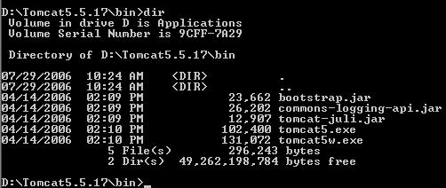

by: omnovaPosted on 2009-08-10 at 12:12:19ID: 25063025
Here's a screenshot of what is available in that directory.

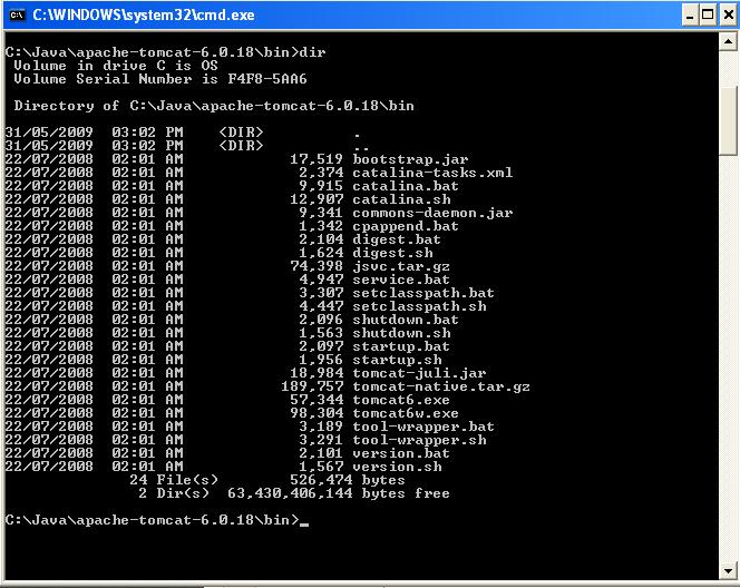

by: kingshaPosted on 2009-08-10 at 12:49:54ID: 25063392
Ok. Below is a screenshot of what mine looks like. I really dont understand why yours is like that. The only reason I can think of is that your tomcat was not installed correctly. Maybe some of the more experienced experts can confirm my suspicion. If you have time, try and install the latest tomcat (6.xx) correctly.

by: omnovaPosted on 2009-08-11 at 12:11:01ID: 31613742
Thanks, now I know that it may not be fully installed which would explain why it is not working.
