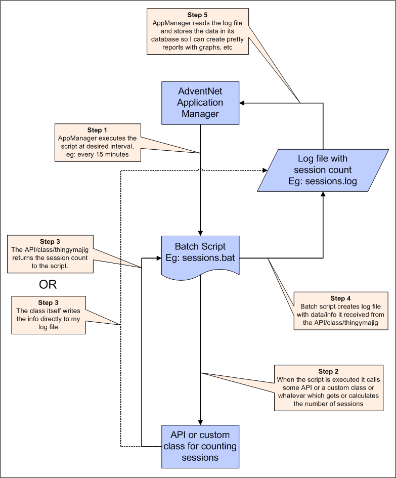

I have attached a little flow chart of how I would like this process to work.  There are 5 steps in the process.  I can currently do steps 1, 4, and 5.  The missing pieces of the puzzle are steps 2 and 3.
Please bear in mind I am not a Java programmer, so please be specific.
