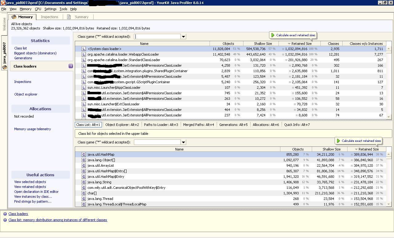

We are using SUN JVM so I have download YOURKIT and loaded the ***.hprof heapdump file into YOURKIT, So what are the things that I need to analyse at this point  to  understand the reason for JVM crash.
Also in what terms do I need to explain the reason for JVM crash based upon the analysis,

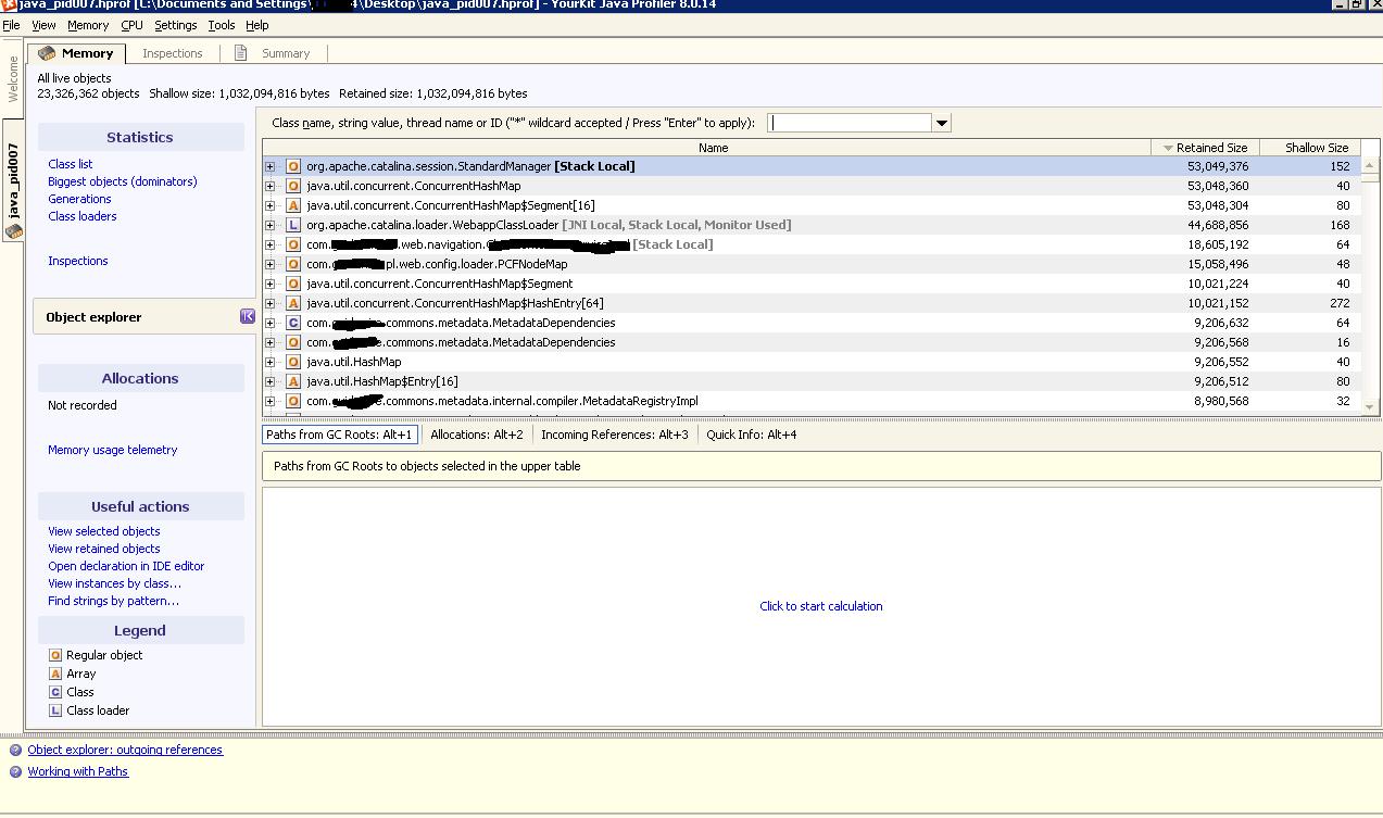

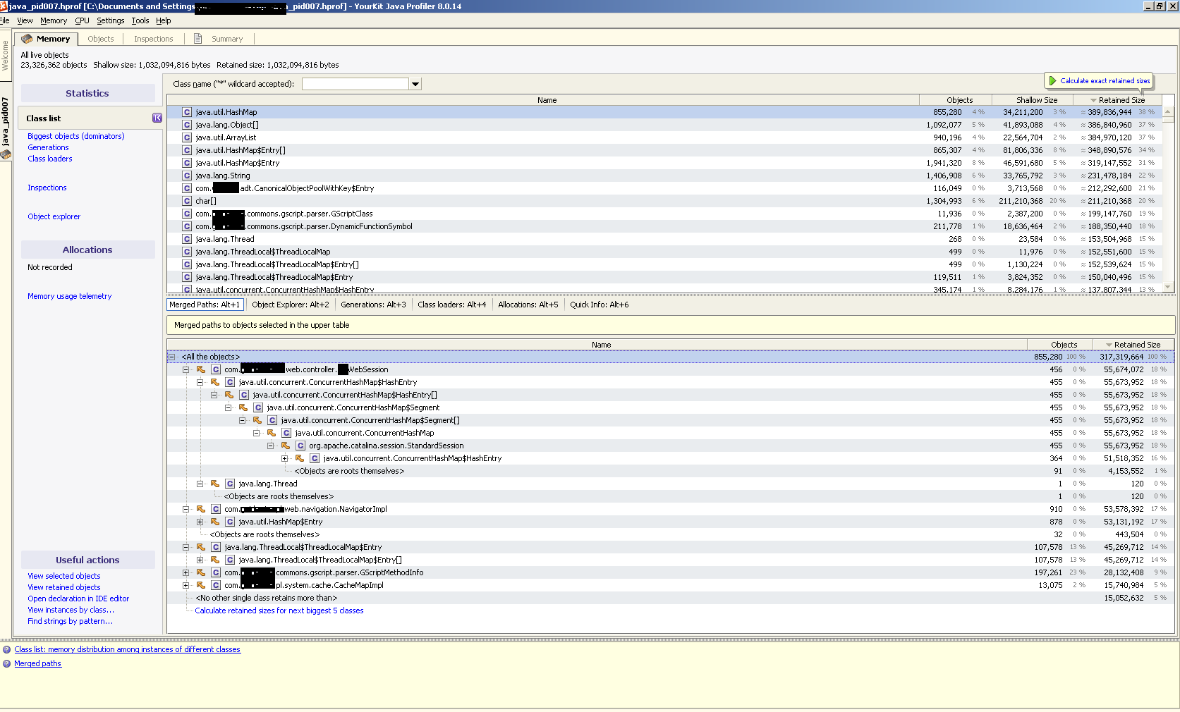

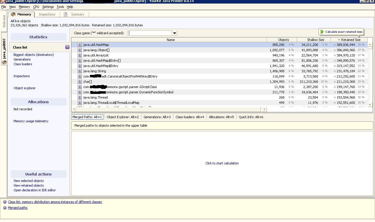

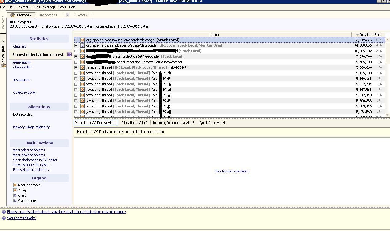

Have also attached the snapshots of heapdump which was loaded into YOURKT.

Your H1.png is useful. Rest of them are specific to a class. It looks like you are having almost 384MB of data stored in HashMap. That is really huge. I guess you might be having 512 or 1 GB RAM for your JVM??
Given that, the ratio of HashMap size seems to be heavy. You might want to click on that HashMap and "click to start collection" in bottom pane. That would let u drill down what is taking more space inside hashmap.
My feeling is that, you might have com.*.CanonicalObjectEntry* hooked on to these hashmaps somehow. If you are not comfortable in reading the code, get the help of developers and ask them what is causing the hashmap to grow in such huge sizes.

Thanks Rajesh, you are absolutely correct we have 1 GB RAM.
So when ever I have the heap dump, do i need to analyse only  HashMap or else need to  start analysing based upon the Retained size coloumn in yourkit.
Also I have clicked on that HashMap and "click to start collection" in bottom pane took the snap shot.. can we analyse anything at this time.

As per 1st image, looks like your HashMap contents are really expensive. Yes, retained size will take sometime to compute. So give it sometime after opening the dump. Based on your computing power, it will take 2 or 3 minutes to compute the retained size.
Retained size gives the size of your hashmap along with its contents. So you would be able to see it in the bottom pane.
If its a leak, mostly the same pattern would emerge and dev should be able to nail it down the contents of the map.

Just viewed your latest image. 314MB of websession???? :)..
Can you check with your dev if its genuine to have this much amount websession data given that you have 1 GB RAM?
almost 30-40% alloted for websession.
