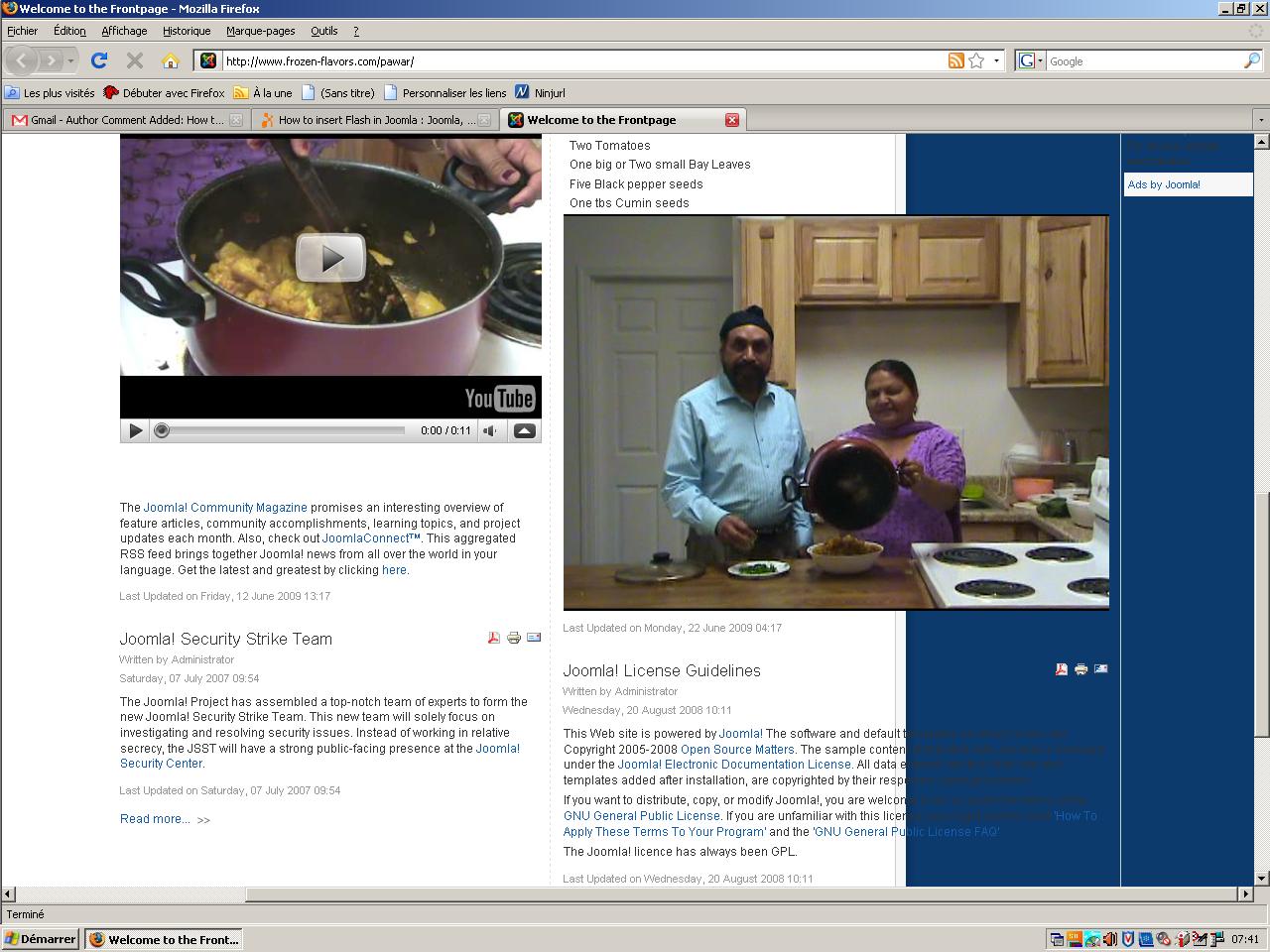

by: dpawarPosted on 2009-06-21 at 21:18:05ID: 24679655
by: dpawarPosted on 2009-06-21 at 22:39:28ID: 24679869
Two videos you see are from YouTube, they are fine,
The other one that is hosted from website is where I get the error message.
by: claraferPosted on 2009-06-21 at 22:50:39ID: 24679910
I don't see any error???
