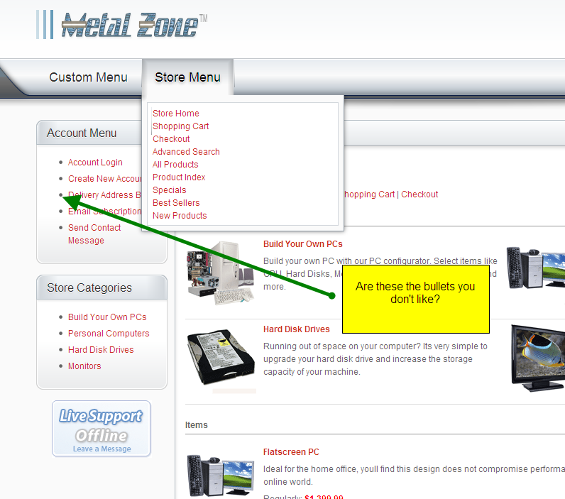

Pls see image - are teh bullets on left teh ones you want removed?
by: j-b-tPosted on 2009-10-04 at 17:35:50ID: 25491671
oops
by: j-b-tPosted on 2009-10-04 at 17:36:21ID: 25491673
uploaded
by: Steel_GoddessPosted on 2009-10-04 at 18:15:28ID: 25491789
Yes... it is those....  I need them gone....
and ideally either:
be able to pick up the module style for the position... or the menu style of the template..
but yes, those are the pesky bullets...
Thanks.

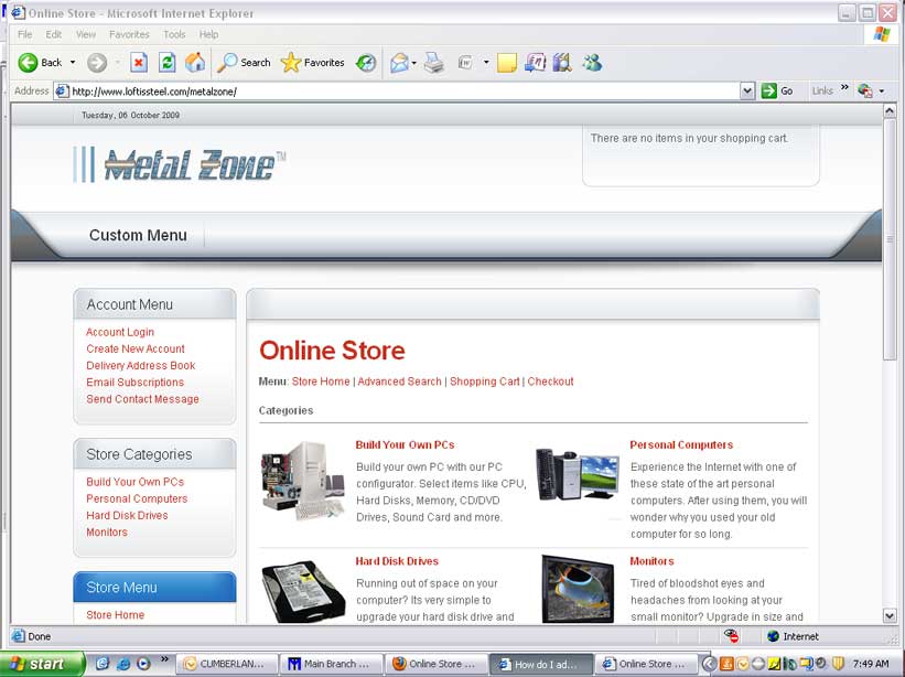

by: Steel_GoddessPosted on 2009-10-05 at 12:45:07ID: 25498874
I had a few moments so I have begun testing..
In Mozilla, the whole menu gets pushed down.... I have 3.014
In IE 6, its ok...
IE7 will have to wait until I return home....
It does take the position styling so that is a very good thing....
These are my only lists in this template, so anything done should only affect these modules...
Is there any possibility in the css to make these lists  behave like the Test Store Menu.. Its the last menu in position left...
And now that the bullets are gone, if I decide to put something else in there, ex. an arrow-- down the road, how do I do that...
Sorry for so many questions...but you've been the only good help...
Link again is:  http://www.lsanashville.com/metalzone/index.php
Thanks!

by: Steel_GoddessPosted on 2009-10-06 at 05:55:06ID: 25504417
Great, I can investigate those in incarnation 2 :-).. To me its a bit trickier, because the lists are not coming from within the template structure, they are being imported from the ecommerce side...
I did update to the latest FF-- and it looks like the older FF...  Is there additional padding variable that needs to be put in there, to push the list up as it appears in IE?
Again thanks.
Alicia
by: j-b-tPosted on 2009-10-06 at 08:39:30ID: 25506283
I am not sure why it looks different in your ff. many. variables os. etc.  can u duplicate. in browsershots.org. is history cleared etc.  ?
by: Steel_GoddessPosted on 2009-10-06 at 12:05:38ID: 25508588
ul.menu{ list-style-type: none; margin-left:-30px; margin-top:0;}
Adding a top margin value seems to have done the trick..
Thanks so much for all your help....
