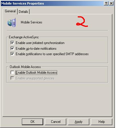

by: LegendZMPosted on 2008-07-30 at 08:36:28ID: 22121517
the OWA server name is the one you need to put unless you dont have the microsoft-server-activesync Virtual Directory
You can tell if it's installed because your mobile properties will look like picture 1 instead of picture 2
by: sirvodkaPosted on 2008-07-30 at 08:56:23ID: 22121716
My properties box looks like #1 but the "enable up-to-date notifications" and "enable notifications" are not checked.
