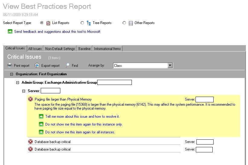

leakim971: using the BPA, the health check shows up this.  (pls refer to attached image)
    • 57 KB
    BPA health check
    BPA health check

As Exchange BPA say it, you should modify the paging size to be equal to your physical memory.
Another thing why have you so much paging size ? 15368 / 6142 = 2.5

Please take care of the Paging file error .......... and check this
