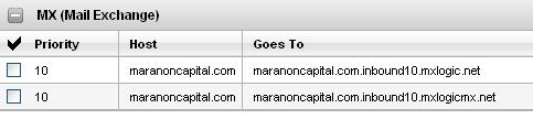

Hi, I have two MX records listed for my DNS control panel. However, when I lookup my MX record only one shows up. Is this normal? Both have the same priority.
Thanks.

But the answer to your question is that the response you get depends entirely upon the tool you use. Depending on the method your using to look it up. Using "dig -t MX gmail.com, dig @server gmail.com mx, or nslookup" you'll clearly see all of your MX records.

I was using nslookup -qt=mx mydomain.com I have attached a snapshot of my mx record.

Your MX records are fine. I looked them up myself:
10      mxlogic.net.inbound15.mxlogic.net      208.65.144.13      43200
20      mxlogic.net.inbound25.mxlogic.net      208.65.144.11      43200
10      mxlogicmx.net.inbound15.mxlogic.net      208.65.144.12      43200
20      mxlogicmx.net.inbound25.mxlogic.net      208.65.144.11      43200

by: AngelmarPosted on 2009-08-31 at 14:36:16ID: 25226763
What did you do differently? Why were my searches only showing one?
by: zefyxftwPosted on 2009-08-31 at 14:44:58ID: 25226817
Possibly because you did the search locally? That I'm unsure of, but I can confirm that your records are in fact correct.
