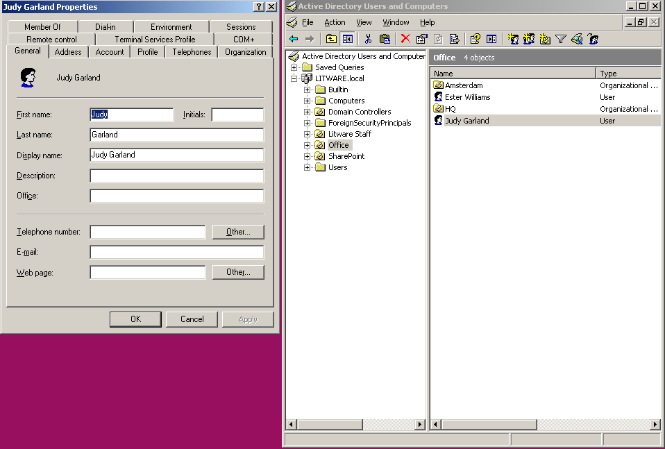

One thing I've not been able to do from your answer to question 4 - is see the OBJECT tab (see image below).  This is in my test environment WITHOUT MS Exchange Installed.  Can I assume this is the reason I cannot see it?

question 4.. IN ADUC go to view and tick the option advanced features then you would be able to see object tab in the user properties.
