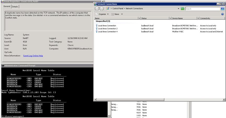

Problem 2:
On my main PDC Windows Server 2008, I receive NO errors in the DNS log but DO receive an error in the system log as follows - also please see the screenshot below:
Source: NetBT
Event ID: 4319
Description:
A duplicate name has been detected on the TCP network. The IP address of the computer that sent the message is in the data. Use nbtstat -n in a command window to see which name is in the Conflict state. (This server box has 2 physical NIC's and one Virtual for hyper-V. All NIC's except the Phyciscal NIC#1 has the box to "Register this connection's address in DNS" unchecked.
Also this PDC server showed NO DNS errors!

System Log for PDC Win2008 with nbtstat -n
