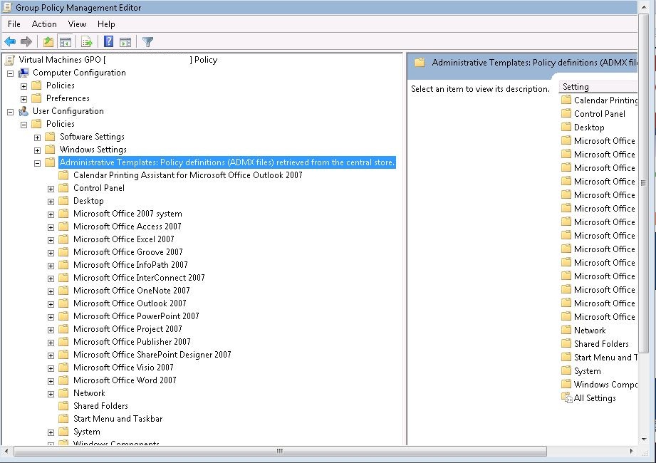

by: BarwaPosted on 2009-10-24 at 11:45:06ID: 25653642
OK , here is what I have done so far:
Following MS article http://support.microsoft.com/kb/929841 , I have done the followings:
  • Created a folder called PolicyDefinitions under C:\WINDOWS\SYSVOL\sysvol\FQDN\Policies on one of our 2003 domain controllers
  • Copied all ADMX files from a normal Vista machine (C:\windows\PolicyDefinitions) to the 2003 DC path specified above
  • Copied all language files from the same Vista machine (C:\windows\PolicyDefinitions\en-US) to the same DC under (C:\WINDOWS\SYSVOL\sysvol\FQDN\Policies\PolicyDefinitions\en-US
  • I have also done the same with Office 2007 files extracted from the MS download link
Now all Vista & Office 2007 ADMX and ADML files are stored on one 2003 DC
Next , I initiated manual replication to all other 2003 DCs.Replication was successful and the new PolicyDefinitions folder has been successful replicated to other DCs
Using a 2008 management station , all Vista & Office 2007 related GPO settings are now available :)
I have noticed that all Vista and Office ADMX files were stored under the same folder.The same applies for the language files
I am not sure if its possible to create a sub-folder for each , one for vista , one for Office and so on
Although the GPO editor is clearly grouping them separately as in the following screen capture
by: mpfisterPosted on 2009-10-25 at 04:44:47ID: 25656330
Give it a try, but I believe it won't recognize ADMX files in subfolders.
