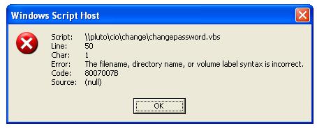

by: ORBITECPosted on 2009-10-16 at 07:01:44ID: 25589623
Yes still an error, but it can find the file see screen shots:
by: ORBITECPosted on 2009-10-16 at 13:34:37ID: 25593101
HURRAY! I got the first script working, however I've developed a new problem..  The second script that is called by the first sript fails if it is run by someone without local admin privileges.  Most of our users have local admin privs to their computer and no others, but some do not.  In this case the password will no be reset if a non admin user logs in.  the error is on line 50 char 1 which is :
objUser.SetPassword "new_password" ' <--- this will be the new admin password.
When the script fails it simly doesn't change the local admin password.  any ideas now?
I've attached the code again in case i've changed anything since last time, so this is the current version.

52:
53:
by: RobSampsonPosted on 2009-10-16 at 15:27:18ID: 25593810
Hmmm, is there any reason that you cannot include the file writing bit into the second script, then just run the second script as a StartUp script instead of a Logon script?  This way, the script will run as the System account and won't need the admin credentials.
The only thing you'll have to do is move the script to the NetLogon share of your domain controllers, so that the SYSTEM account can read the script to run it.
Regards,
Rob.
by: ORBITECPosted on 2009-10-23 at 12:33:22ID: 25647586
I will try this on the weekend and post back.
by: RobSampsonPosted on 2009-10-31 at 15:07:06ID: 25711750
Hi there, did you manage to try this as a StartUp script?
Regards,
Rob.
by: ORBITECPosted on 2009-11-04 at 12:00:05ID: 25743281
I tried it as a start up script but it didn't work I can't remember if i had figured out why.
by: RobSampsonPosted on 2009-11-05 at 17:42:40ID: 25756031
OK, I've pieced your bits of code together, such that this should work as a logon script, provided that you change
"\\pluto\software\change\Finished.txt"
to something like
"\\domain.com\sysvol\domain.com\scripts\AdminPasswordChange\Finished.txt"
Where \\domain.com\sysvol\domain.com\scripts will refer to the same location as your NetLogon share of your domain controllers, and AdminPasswordChange is a folder in the NetLogon share to write the text file to.
You can test the script out manually while logged in as an administrator first.
Regards,
Rob.

by: RobSampsonPosted on 2009-12-08 at 15:53:22ID: 26003842
AngelIII, in my latest comment (ID:25756031) I stated:
but I actually meant
>> such that this should work as a *startup* script
If it is applied in this way, it would suit the author's need, I believe.
Regards,
Rob.
