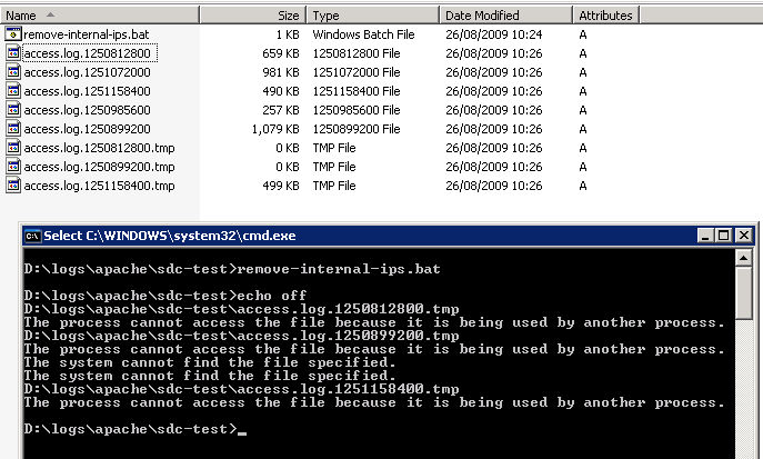

Tried the code above but getting this:
D:\logs\apache\sdc-test>remove-internal-ips.bat
D:\logs\apache\sdc-test\access.log.1250812800.tmp
The process cannot access the file because it is being used by another process.
D:\logs\apache\sdc-test\access.log.1250899200.tmp
D:\logs\apache\sdc-test\access.log.1251158400.tmp
D:\logs\apache\sdc-test\access.log.1251244800.tmp
The system cannot find the file specified.

by: NeilTPosted on 2009-08-26 at 02:37:56ID: 25185707
attached along with cmd prompt screen shot
by: BlundeyPosted on 2009-08-26 at 02:43:42ID: 25185729
did you remove the echo off statement? As the above does not show clearly where it is getting stuck...
let me see if i can add a delay into the mix as your processor might be so quick that it is trying to copy the file before closing it....one second
by: NeilTPosted on 2009-08-26 at 02:50:40ID: 25185770
yes echo off
