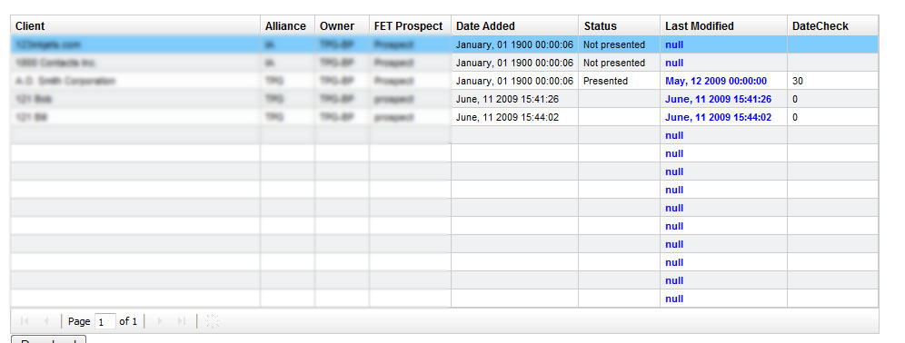

Ok. Got something to happen this time. All the text in the column is now blue even the hidden "null" values ;)
Ideally I'd like to change the background of the entire row if possible or just the color of those cells that validate to the date logic I need to put in place.
Would this be of any help in making that happen?

by: futr_visionPosted on 2009-06-10 at 15:59:24ID: 24597349
Oh - "date modified" is in datetime format. I'd like to mask the time portion but apparently that is only;y available for Flash cfgrids.

by: larksysPosted on 2009-06-10 at 18:54:15ID: 24598191
!. textcolor and bgcolor are paramaters of the cfgricolumn tag. You can use it to color the text or background of a grid cell. You can use the same expression on all grid columns if you wish to color the row. But you need some test like I usedd in the example. You can use your grid bind query to create a column for the grid (datecheck) and use that column to set the color of all the other columns.
2. You can add the SQL statement to create the datecheck column for use in the cfgrid. Maybe you should post your SQL code.
These are the 2 options that I can think of to change the color of gridf columns;
         A. Use the EXT code and change the javascript to test the date column to determine if you want to change the column color.
         B. Use the textcolor or bgcolor paramaters of the cfgridcolumn tag to change the colors.

by: larksysPosted on 2009-06-10 at 19:45:01ID: 24598372
<cfquery name="clients" datasource="#THIS.dsn#">
      SELECT *,(datediff(now - last_modified) as datecheck<----------- add this code
      FROM Clients
      <cfif gridsortcolumn NEQ ""
         and gridsortdir NEQ "">
         ORDER BY #gridsortcolumn# #gridsortdir#
      </cfif>
      </cfquery>
Add this grid column;
<cfgridcolumn name="DateCheck" display="no"/>
Change this grid column;
<cfgridcolumn name="last_modified" width="140" header="Last Modified" bgcolor = "(c11 lt 30 ? blue : white)"/>
Actually make the datechecck column display="yes" so you can see the data (temporary).
by: futr_visionPosted on 2009-06-10 at 23:47:37ID: 24599341
Adding ,(datediff(now - last_modified) as datecheck causes the app to throw an error.
by: larksysPosted on 2009-06-11 at 08:05:38ID: 24603209
What's the error?  Post the SQL code
by: futr_visionPosted on 2009-06-11 at 12:07:48ID: 24605676
I get a dialogue box on loading that says:
 Error invoking CFC /CFC/clients.cfc : Internal Server Error [Enable debugging by adding 'cfdebug' to your URL parameters to see more information]
Firebug is showing the getClient method in the CFC failing.
by: larksysPosted on 2009-06-11 at 13:56:32ID: 24606793
Can you look at the application log on your CF server? It would have details of the error.
by: larksysPosted on 2009-06-11 at 14:08:43ID: 24606893
I believe I got the following code wrong;
It should be;
  SELECT *,(datediff("d", last_modified,#now()#) as datecheck<----------- add this code
I just verified this in my code.
by: futr_visionPosted on 2009-06-11 at 14:11:24ID: 24606919
I don't have access to that but I can ask for it. I'd try an test this locally but I'd have to spend some time setting up the DB and CF but that will probably take longer.
by: larksysPosted on 2009-06-11 at 14:29:38ID: 24607089
make the change I suggested and that will probably fix the error
by: futr_visionPosted on 2009-06-11 at 15:51:00ID: 24607697
Well, it's still throwing an error.
by: futr_visionPosted on 2009-06-11 at 16:01:34ID: 24607755
Aha!
The parentheses in front of datediff is the culprit. I'm now getting values in my grid of either 0 or 30. Now I need to get the last_modified column to check that value and color the row based on whether that value is 30 or greater right?
by: larksysPosted on 2009-06-11 at 17:31:35ID: 24608293
Right. You can do that with either the EXT code or the bgcolor parameter of the cfgridcolumn tag.
by: futr_visionPosted on 2009-06-11 at 17:52:45ID: 24608370
Maybe it's just a lack of sleep but I can't get this to work. Here is the code that I am currently using(not including the query in the cfc) and a screengrab of the current results.
<!--- Customer Render code in the head --->
<cfajaximport tags="cfform, cfdiv, cfgrid">
<!--- Rendering for date modified in excess of 90 days --->
<script type="text/javascript" language="javascript">
// custom renderer for Color column
function renderName(data,cellmd,record,row,col,store) {
 return '<b style="color:blue;">' + data + '</b>';
// function to invoke custom renderers and return re-configured grid (called from ajaxonload()
function CompRendGrid() {
  mygrid = ColdFusion.Grid.getGridObject('clients');
  cm = mygrid.getColumnModel();
  cm.setRenderer(7,renderName); // assign custom renderer for Name column in the grid
  mygrid.reconfigure(mygrid.getDataSource(),cm); // reconfigure grid
</script>
<!--- fire the custom grid renderers on pageload --->
<cfset ajaxOnLoad("CompRendGrid")>
<!--- Customer Render code in the grid --->
        <cfgridcolumn name="last_modified" width="140" header="Last Modified" bgcolor = "(c11 lt 90 ? blue : white)"/>
 	<cfgridcolumn name="DateCheck" display="yes"/></cfgrid>
by: larksysPosted on 2009-06-11 at 18:04:05ID: 24608409
You're trying to use both methods. Comment out lines 1 through 19.  Now you're checking for less than 90 days and the bgcolor should be blue. Let's see what it does now.
by: futr_visionPosted on 2009-06-11 at 19:33:57ID: 24608697
I took out the method and not I am not getting any changes to the grid.
by: larksysPosted on 2009-06-11 at 23:04:05ID: 24609522
Use this;
 if (record.data.DATECHECK < 90 return '<b style="background-color:ffff80>' + data + '<b>';
 else return data;
  cm.setRenderer(1,renderName); // assign custom renderer for Name column in the grid
 cm.setRenderer(2,renderName); // assign custom renderer for Name column in the grid
 cm.setRenderer(3,renderName); // assign custom renderer for Name column in the grid
 cm.setRenderer(4,renderName); // assign custom renderer for Name column in the grid
 cm.setRenderer(5,renderName); // assign custom renderer for Name column in the grid
 cm.setRenderer(6,renderName); // assign custom renderer for Name column in the grid
 cm.setRenderer(8,renderName); // assign custom renderer for Name column in the grid
 cm.setRenderer(9,renderName); // assign custom renderer for Name column in the grid
 cm.setRenderer(10,renderName); // assign custom renderer for Name column in the grid
by: larksysPosted on 2009-06-11 at 23:06:50ID: 24609535
Sorry, only render columns 2 through 9.  I just realized that the datecheck column is number 10.
by: futr_visionPosted on 2009-06-12 at 03:40:13ID: 24610835
I gave it a try and the app fails silently. Firebug did pick up an error. Here is the syntax of that error
missing ) after condition
? in cfajax.js@99()cfajax.js (line 103)
? in cfajax.js@118("/CFC/clients.cfc", "GET", "method=getClientsAdmin&returnFormat=json&argumentCollection=%7B%22page%22%3A1%2C%22pageSize%22%3A15%2C%22gridsortcolumn%22%3A%22DATECHECK%22%2C%22gridsortdir%22%3A%22ASC%22%7D", true, function(), null, true)cfajax.js (line 119)
? in cfajax.js@454(Object async=true cfcPath=/CFC/clients.cfc httpMethod=GET, "getClientsAdmin", Object page=1 pageSize=15 gridsortcolumn=DATECHECK, Object bindToAttr=true bindToParams=Object)cfajax.js (line 488)
? in cfajax.js@1562(null, Object bindToAttr=true cfc=/CFC/clients.cfc)cfajax.js (line 1584)
? in my_page.cfm@103(Object events=Object _cf_actions=Object _cf_firstLoad=true, 1, 15, "DATECHECK", "ASC", null, function(), Object data=Object baseParams=Object paramNames=Object, Object params=Object, Object)my_page.cfm (line 105)
? in cfgrid.js@481(Object start=0 limit=15 sort=DATECHECK dir=ASC, Object, function(), Object data=Object baseParams=Object paramNames=Object, Object params=Object)cfgrid.js (line 498)
? in data.js@11(Object params=Object)data.js (line 11)
? in data.js@11("DATECHECK", "ASC")data.js (line 11)
? in grid.js@11(Object container=Object id=cfgrid1244802916990, 8)grid.js (line 11)
? in ext-core.js@12()ext-core.js (line 12)
? in grid.js@9("click", Object browserEvent=Event unload button=-1 type=unload)grid.js (line 9)
? in grid.js@9(Object browserEvent=Event unload button=-1 type=unload)grid.js (line 9)
? in ext-core.js@13()ext-core.js (line 13)
? in yahoo-dom-event.js@135()yahoo-do...-event.js (line 135)
[Break on this error] if (record.data.DATECHECK < 90 return '...ckground-color:ffff80>' + data + '<b>';\n
I've even added a parenthese at the end of the if statement but it still throws the same error
by: futr_visionPosted on 2009-06-12 at 03:56:37ID: 24610914
I just added the parenth before the return statement and the error is now gone however I am not seeing any changes to the grid. I also added a closing quote on the the style. That didn't produce any results either.
by: larksysPosted on 2009-06-12 at 08:21:24ID: 24613150
Yeah, there was a missing paren after 90 and the semicolon and quote after the color code;
 if (record.data.DATECHECK < 90) return '<b style="background-color:#ffff80;">' + data + '<b>';
 else return data;
You should also add the # sign in front of the color code.
by: futr_visionPosted on 2009-06-12 at 08:42:29ID: 24613342
Still nothing. No errors but no coloring either.
by: larksysPosted on 2009-06-12 at 09:02:29ID: 24613559
Is this a public page that I might look at?
by: futr_visionPosted on 2009-06-12 at 09:25:09ID: 24613772
Unfortunately it is behind registration.
by: larksysPosted on 2009-06-12 at 09:33:17ID: 24613849
Did you remove the bgcolor parameter from the cfgidcolumn tag? You should.
by: futr_visionPosted on 2009-06-12 at 09:51:35ID: 24613995
Yes. Here is what the cfgrid looks like now.
    <cfform name="Clients" >
      <cfgrid name="clients"
         format="html"
         striperows="yes"
         colheaderbold="yes"
         colheaderfontsize="12"
         pagesize="15"
         selectmode="edit"
         delete="yes"
         bind="cfc:CFC.clients.getClientsAdmin({cfgridpage},{cfgridpagesize},{cfgridsortcolumn},{cfgridsortdirection})"
         onchange="cfc:CFC.clients.editClient({cfgridaction},{cfgridrow},{cfgridchanged})">
        <cfgridcolumn name="client_ID" display="no" />
        <cfgridcolumn name="client_name" width="275" header="Client"/>
        <cfgridcolumn name="alliance" width="60" header="Alliance"/>
        <cfgridcolumn name="owner" width="60" header="Owner"/>
        <cfgridcolumn name="FET_prospect" width="90" header="FET Prospect"/>
        <cfgridcolumn name="date_added" width="140" header="Date Added"/>
        <cfgridcolumn name="status" width="90" header="Status"/>
        <cfgridcolumn name="last_modified" width="140" header="Last Modified" />
        <cfinput type="button" name="Download" value="Download" onClick="doDownload()">
   </cfform>
by: larksysPosted on 2009-06-12 at 09:52:47ID: 24614009
This is what I'm using and it turns the background of all cells to yellow;
<!--- Special rendering for company name colors --->
function renderName2(data,cellmd,record,row,col,store) {
 if (record.data.DATECHECK < 10) return '<b style="background-color:#ffff80;">' + data + '<b>';
 else return data;
function CompRendGrid2() {
  mygrid = ColdFusion.Grid.getGridObject('grid_Companiesviewed');
  cm.setRenderer(1,renderName2); // assign custom renderer for Name column in the grid
 cm.setRenderer(2,renderName2); // assign custom renderer for Name column in the grid
 cm.setRenderer(3,renderName2); // assign custom renderer for Name column in the grid
 cm.setRenderer(4,renderName2); // assign custom renderer for Name column in the grid
 cm.setRenderer(5,renderName2); // assign custom renderer for Name column in the grid
</script>
<cfset ajaxOnLoad("CompRendGrid2")>
by: larksysPosted on 2009-06-12 at 09:54:26ID: 24614020
You might try removing the striperows parameter from the cfgrid tag.
by: futr_visionPosted on 2009-06-12 at 09:59:09ID: 24614051
Removed. No luck. You're really working for these 500 pts huh? I really appreciate your persistence.
by: larksysPosted on 2009-06-12 at 10:19:42ID: 24614223
Change the following line;
 else return data;
To;
Let's see what happens.
by: futr_visionPosted on 2009-06-12 at 11:14:40ID: 24614711
I hate to say this but nothing happens. No errors. No colors. Just data.
by: larksysPosted on 2009-06-12 at 13:01:28ID: 24615585
Post your code, please.
by: futr_visionPosted on 2009-06-12 at 13:54:21ID: 24616085
Here is the script and the grid
<!---custom renderer for Color column--->
<!---function to invoke custom renderers and return re-configured grid called from ajaxonload--->
</script>
    <cfform name="ClientsAdmin" >
         format="html"
         colheaderbold="yes"
         pagesize="15"
         selectmode="edit"
         delete="yes"
        <cfgridcolumn name="status" width="90" header="Status" />
        <cfgridcolumn name="last_modified" width="140" header="Last Modified"/>
   </cfform>
by: futr_visionPosted on 2009-06-12 at 13:58:51ID: 24616112
and the query
   <cffunction name="getClientsAdmin" access="remote" returntype="struct">
      <cfargument name="page" type="numeric" required="yes">
      <cfargument name="pageSize" type="numeric" required="yes">
      <cfargument name="gridsortcolumn" type="string" required="no" default="">
      <cfargument name="gridsortdir" type="string" required="no" default="">
      <!--- Get data for Admin grid --->
      FROM Clients
         ORDER BY client_name ASC #gridsortcolumn# #gridsortdir#
      </cfif>
      </cfquery>
      <!--- And return it as a grid structure --->
    <cfreturn queryconvertforgrid(clients,page,pagesize)/>
   </cffunction>
by: larksysPosted on 2009-06-13 at 07:23:04ID: 24619327
You're missing some code.
by: futr_visionPosted on 2009-06-13 at 10:28:14ID: 24620000
I finally got this working. A good night's sleep and a peak at a few other examples and I believe I figured out what was going wrong. Once I moved the <cfset ajaxOnLoad("CompRendGrid2")> to the very bottom of the page just before the closing body tag it worked. That bit of code has to exist after the grid I want the custom renderer applied to. I've also gone ahead and switched the background style back to the text style. I thought that maybe the background color would fill the entire cell and not just the arae around the text but I was wrong. I also added a little extra code to color other values in the grid. I thought it may throw and error because I didn't define a range but what I have still appears to work. Below is my final code.
<!--- import for custom renderer since we are not using cf8 ajax controls. top of page above opening html tag --->
<cfajaximport/>
<!--- Custom renderer that colors the text in each row based on certain values in DATECHECK column --->
renderName = function(data,cellmd,record,row,col,store) {
if (record.data.DATECHECK >= 90) return '<b style="background-color:red;">' + data + '</b>';
  else
if (record.data.DATECHECK >= 60 ) return '<b style="color:orange;">' + data + '</b>';
	else
if (record.data.DATECHECK >= 30 ) return '<b style="color:green;">' + data + '</b>';else return data;
CompRendGrid = function() {
</script>
<!--- fires our custom grid renderers on pageload. Placed after grids before closing head tag --->
by: futr_visionPosted on 2009-06-13 at 14:21:36ID: 31591067
It was a long hall and I appreciate your patience. Thanks. Turns out it was another post here at experts-exchange that included yourself that help me finally get this working.
