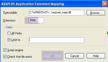

am following this article to so that my HTTP handler classes can work with static content like .bmp, .html in asp.net.
http://msdn.microsoft.com/en-us/library/ms228090%28VS.80%29.aspx
the Ok button is greyed out when i try to configure in IIS. This is just on my local machine at the moment, just a standard laptop with XP Pro.
following these steps from the article. i edited the content to avoid any copyright infringements :
To map the .sample file name extension to ASP.NET in IIS 6.0
   1. Open the eternal Internet Information Services (IIS) Manager.

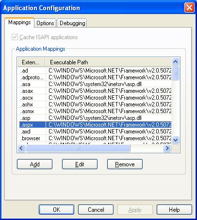

   2. Go on ! do a Right-click the name of your awesome asp.net application, and then click   Properties.
   3. Click the beloved Virtual Directory tab, and then click Config
   4. On the Mappings tab, click Add.
   5.The Add/Edit Application Extension Mapping dialog box is displayed.
       In the Executable box, type or browse to the file Aspnet_isapi.dll. you know where it is..
   6.In the Extension box, type .sample.
   7.Clear the Verify that file exists check box.
   8.Click OK and then close IIS Manager.  [ I can't do this !! it is greyed out ]

by: dariuscssiiPosted on 2009-08-11 at 14:38:33ID: 25073749
it is STILL greyed out !
just added info: am logged in as an admin
by: meverestPosted on 2009-08-12 at 16:14:20ID: 25084041
*what* is greyed out?  the 'OK' button?
Cheers.
by: dariuscssiiPosted on 2009-08-12 at 16:33:53ID: 25084243
indeed, yea the 'Ok' button on the Add/Edit Application Extension Mapping dialog box.
by: meverestPosted on 2009-08-12 at 19:58:47ID: 25085172
can you post a screenshot of this problem?
cheers.
by: dariuscssiiPosted on 2009-08-13 at 03:59:44ID: 25086930
doesn't matter what i do in that dialog box. the 'ok' button never wants to enable itself.

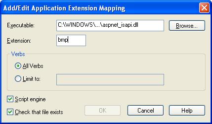

by: meverestPosted on 2009-08-13 at 05:23:14ID: 25087340
try entering a period before the file extension, as in ".bmp" instead of just "bmp", as indicated in the instructions.

by: meverestPosted on 2009-08-13 at 15:16:54ID: 25093598
that's odd.  I can reproduce your problem when I enter data like the first snapshot, but when I add the period, the OK button becomes active.
are you sure that c:\windows\..\aspnet_isapi.dll actually exists in that location?  Apparently it is in the drive root(?)

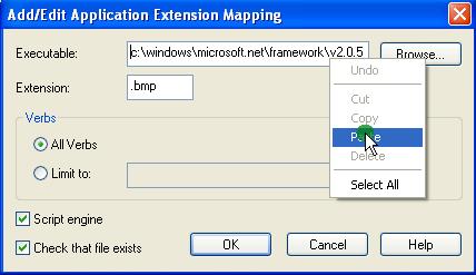

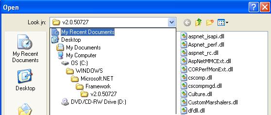

by: meverestPosted on 2009-08-14 at 00:14:32ID: 25095770
well,... but you see that none of them are explicitly "c:\windows\..\aspnet_isapi.dll" - what happens if you try to use "c:\windows\microsoft.net\framework\v2.0.50727\aspnet_isapi.dll" instead?
