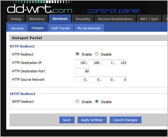

I have linksys router with DD-WRT frimeware where I make a redirection for 80 port to my private IP.
Details:
public IP Address 212.35.x.y
router private address 192.168.1.1
my pc address 192.168.1.125  (this pc hosts the dotnetnuke website)
I did something but did not work. Please see the attached picture.
thank in advance
Saed

by: ping_itPosted on 2009-09-05 at 14:20:59ID: 25267777
Hello,
that should be right. In http destination IP you should put 192.168.1.125.
And http source network it needs to be empty.
Try to configure it as in the screenshot - then try to open cmd and put this command:
telnet 192.168.1.125 80
and
telnet 192.168.x.y 80
and thell me the output

by: ping_itPosted on 2009-09-05 at 14:42:09ID: 25267845
it seems that this hotspot function is there to redirect internal http requests to a proxy for traffic filtering...
and the source network is the address of the network from which the traffic should be filtered - sent to the proxy
So my idea is this:
I have DD-WRT v23 SP2 09/15/06 (old but good)
go to:
-Applications and Gaming
-Port Forwarding
application=http; port from=80; protocol=tcp; IP Address=192.168.1.125,port to=80;enable=yes
click to "add"
and try now...
