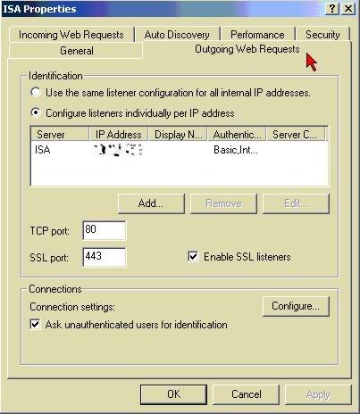

there is a standard that ISA are useing both 8080 and 80 to use some kind of webproxy managment stuff. on the ISA console can you press properites and look at "Outgoing web requests" there it should stand 80 on the TCP field. . try changing this and restart the sercvic.
Regards aamodt

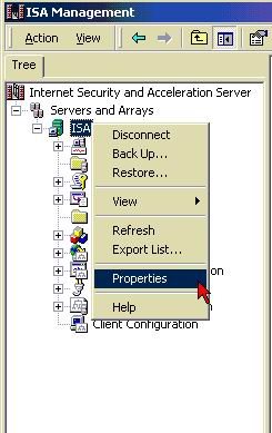

by: aamodtPosted on 2009-09-28 at 06:13:36ID: 25439005
Hm, so you are accessing this like the picutre under here ? Chould might be abit diffrent, im not working with 2004 version now myself so hard to look for the right option.
Regards Aamodt
by: Andy_1205Posted on 2009-09-28 at 06:43:17ID: 25439248
unfortunately i am on ISA 2004 and it looks completely different to this.
It looks like you are editing the port for the SBS web listeners, is this the case?
My Web listener is set to Enable HTTP on Port 80 and SSL on 443; also i have a companyweb listener which is only set to Enable SSL on port 444, no HTTP is configured.

by: keith_alabasterPosted on 2009-09-28 at 10:39:53ID: 25441380
the diagram linked to above is for ISA2000, not 2004.
no, you cannot unbind ISA from using those ports although generally ISA would be listening for 80 and 443 on the external nic ip only. On the internal nic ip ISA would be listening on port 8080 generally as that is the default web proxy port.
