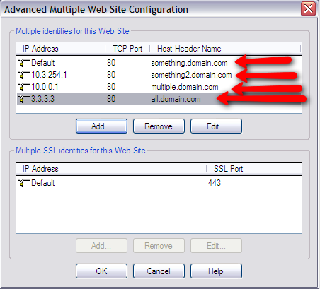

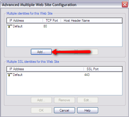

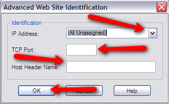

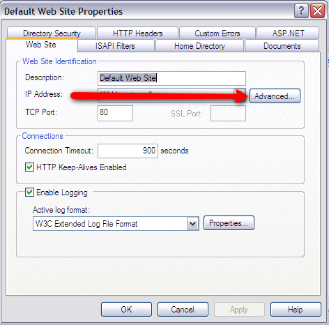

by: pr0t0c0l12Posted on 2009-10-05 at 17:14:12ID: 25501036
you can use different IP addresses and assign each to each web service.  You need to add four virtual connections receiving internet traffic each.  You have to make sure that all correspond to each IP.  Please check the following screens and all the information is fictitious but just as an example to show how to configure...
Hope this makes sense!
Good luck!
