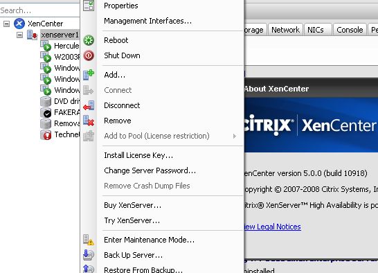

If you want prove take a look at the screenshot I just took (http://www.gobien.be/root/wiki/hardware/virtual/xenserver5express-nolimit4guests.jpg or see attachment):
On the screenshot  you see 5 guests running, the version is 5.0 and i have no license.
by: larstrPosted on 2008-12-03 at 14:57:12ID: 23091189
You're absolutely correct, GoBieN! Citrix really need to update their docs...
