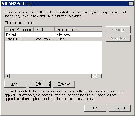

by: pfcjokerPosted on 2009-03-23 at 16:02:17ID: 23963152
Have you tried setting your setup to Default = Alternate (not translated)?
Like Shown below
by: terrabull47Posted on 2009-03-23 at 16:18:12ID: 23963245
yes. and then I deleted firewall translation rules in manager just to make sure there arent any "conflicts", also when i had them in before for all the ports "type" was client since im not using a gateway. other option was gateway or both
