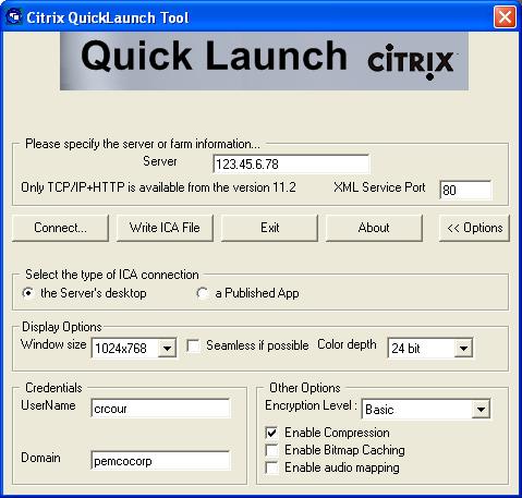

Finally got a resolution today.
For anyone experiencing the same problem, this is what I did:
(1) Downloaded the Citrix Online Plug-in located at: http://www.citrix.com/English/ss/downloads/details.asp?downloadId=1858087&productId=186&c1=sot2755
Please note that there is also a "Citrix Online Plug-in WEB" for those who wish to access Citrix from a Browser.
(2) Because the Plug-in no longer downloads or supports Program Neighborhood, I had to download CitrixQuickLaunch1.2.exe which can be found at: http://support.citrix.com/article/CTX122536
You then get the following dialog box from which to set your options and launch the application.
Bottom line: SLOW REPAINTING PROBLEM IS GONE. Screens now repaint instantly.
