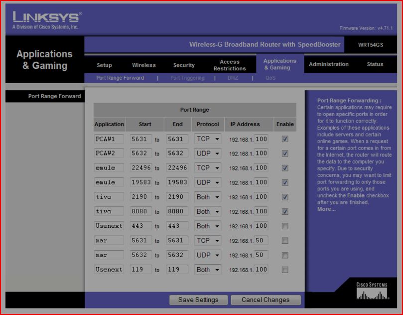

by: susanbsPosted on 2008-06-03 at 20:40:00ID: 21706729
I've tried disabling both the router fire wall and the Windows fire wall to no avail.
Please see the attached jpeg. It is the port forwarding page from my router. Is there anything I should change here? Are there any other router settings I should check?
by: kieran_bPosted on 2008-06-03 at 20:44:51ID: 21706764
That looks right, assuming the machine we are connecting to is .100
Did you try it internally to see if it worked?
