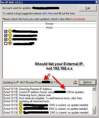

it works with routers in that the router has a section in it's management console to enter your no-ip username and password.  I also use No-IP and run the GUI client on the physical machine.  it does indeed pass the external ip address
    • 59 KB
    Image of the NO-IP DUC v2.2.1 client working properly.
