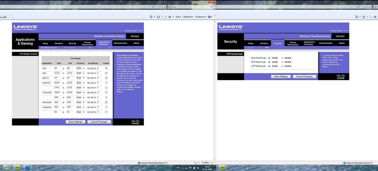

I have attached some screenshots from the router

MCSA2003 mentioned earlier that this router does not support GRE pass-through. There are other similar references  on the internet. I know it does work with some models for sure, but to confirm; this is the same router you used with SBS2003? If so we know the router supports the protocol.
You configurations in the images are fine, and should be all that is required for the VPN.
Just for the record, there is no need to have port 80 forwarded and RWW on SBS 2008 uses port 987. I see you have that present just not enabled, so you likely have reasons.
OneCare can definitely block the VPN access, but if you create the VPN using the SBS wizard it should automatically allow access from off site. Did you also install Forefront with the server? Again if so it is critical to use the SBS wizard, and not the RRAS wizard.
