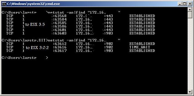

by: larstrPosted on 2008-07-02 at 01:24:19ID: 21914371
I think the original question here was about the connection directly to an ESX server from the viclient.
For testing this I also tried manually connecting to both an ESX 3.5 and ESX 3.0.2 server directly with the viclient to see what ports that were in use (see attached pic).
I also tried connecting the viclient to VC 2.5 and it showed only connections on port 443 while console conections are going directly to each ESX server on port 903.
Lars
