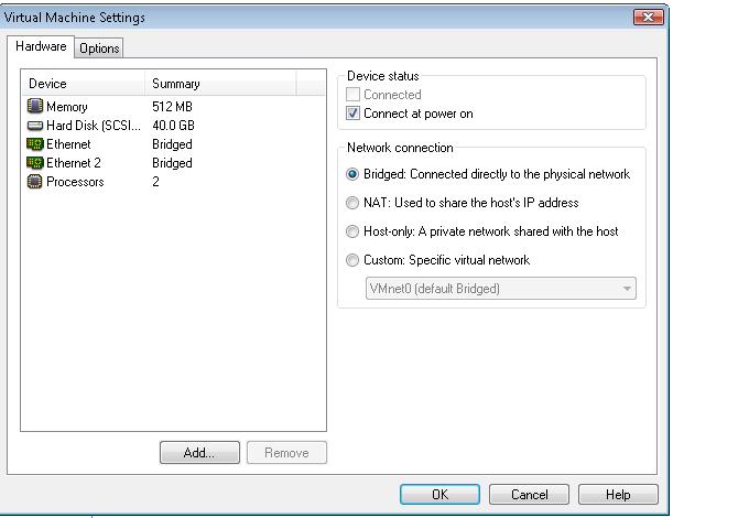

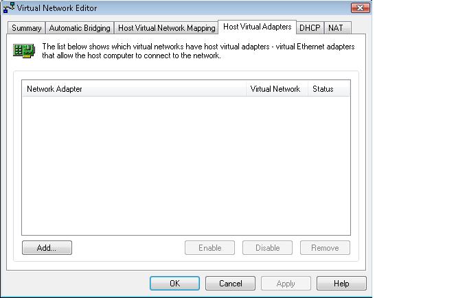

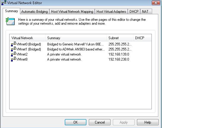

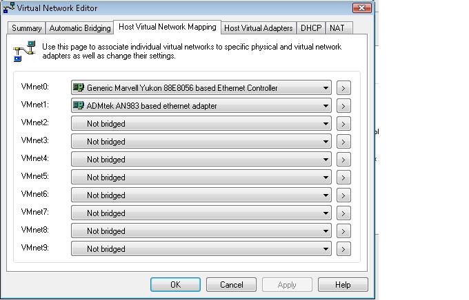

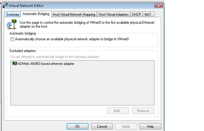

I have a new installation of vmware ws 6.0.
Here is my setup:
Host PC has 2 NICS
NIC 1 is Internet connection to cable modem and set to Dynamic IP
Nic 2 is lan connection and set to 192.168.1.4
VMware Guess needs 2 NICS
Nic 1 is internet connection and set to dynamic ( i want it to get ip from cable modem)
Nic 2 is lan connection and set to 192.168.1.250
I cant seem to get both the nics working. When i make NIC 1 the default bridge, I can get NIC 1 to work and surf the web, but then NIC2 wont respond. If i make NIC 2 the default bridge, i can ping NIC2 from any other pc on my network, but wont get an external ip from cable modem.
I have attached pictures of my settings, what am i doign wrong? I have very little vmware experience so im sure its something im doing.

by: bstrauss3Posted on 2008-09-23 at 16:00:44ID: 22554978
For BOTH nics, choose CUSTOM (not bridged) and point #1 at the Cable Modem and #2 at the private lan
-----Burton
by: bstrauss3Posted on 2008-09-23 at 16:01:50ID: 22554985
that is #1 -> vmnet0 and #1 -> vmnet1
The 1st bridge is what happens on your host, the second 'bridge' (which you don't want) is for the VM itself.
-----Burton

by: bstrauss3Posted on 2008-09-23 at 18:37:25ID: 22555932
Your VM5.jpg shows the configuration of the network cards on the virtual machine.
Change both network cards to 'custom' and select vmnet0 for #1 and vmnet1 for #2.
------Burton
