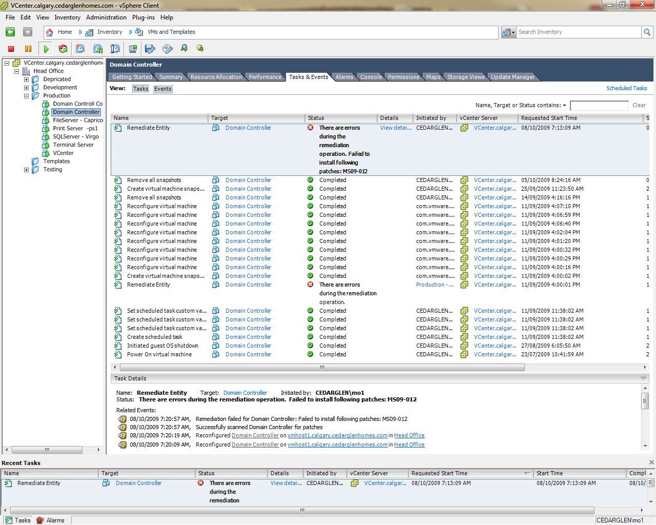

I am having trouble remediating 3 of my servers. most of the patches install fine but for a few patches I keep getting the error below and no explanation as to why in the logs. simply that it failed to install
There are errors during the remediation operation.  Failed to install following
patches:
Has anyone experienced this issue or know how to work around it

Do you  have any logs or screen shots of your issue?
by: mattolanPosted on 2009-10-08 at 06:34:28ID: 25525143
This is all VCenter is showing for the error, and it doesn't seem to be in the logs that I can see
