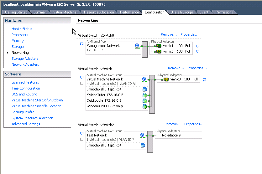

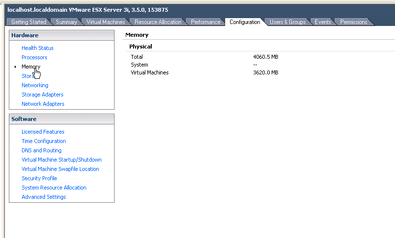

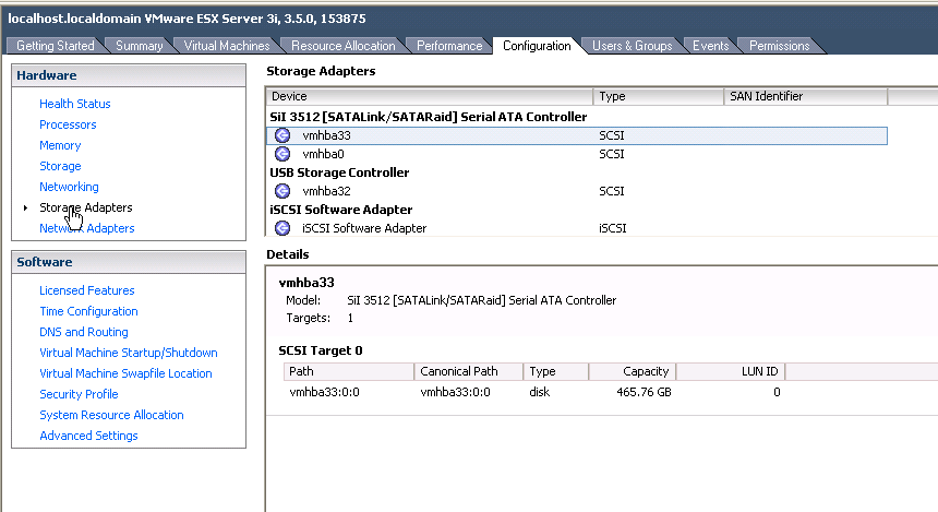

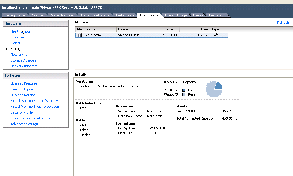

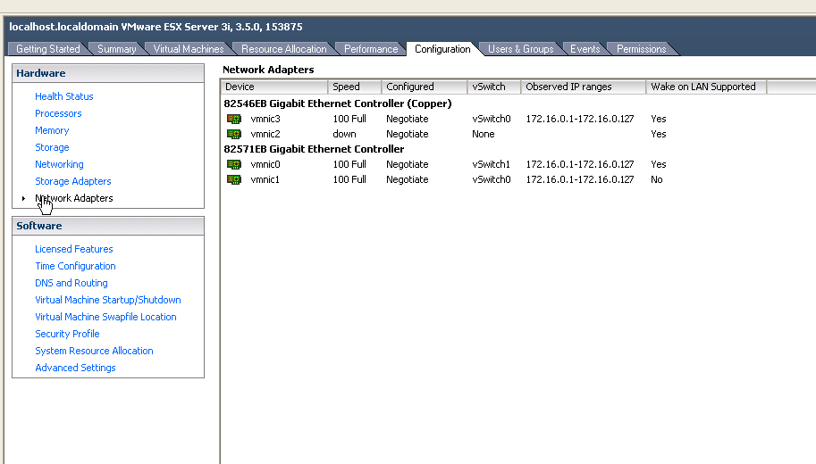

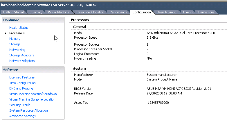

by: nappy_dPosted on 2009-11-07 at 17:16:00ID: 25768928
Here is my config.  Speed is not of great necessity for what I do with it in my home office's lab.
See the screenshots below.  Altogether, I think it cost me under $500 and that is because of the 2, 500GB sata drives I purchased.
