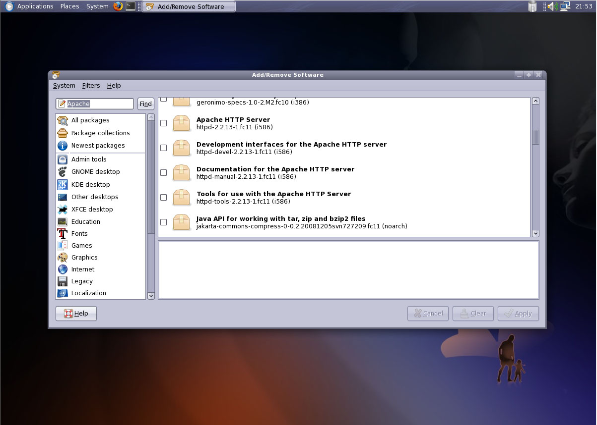

by: garycasePosted on 2009-09-16 at 12:57:58ID: 25349451
Yes, you can do updates, add programs, etc.    Here's a small segment of the Add/Remove software result in Fedora 11 for "Apache":   (this is using the Bagside "appliance" I mentioned above)
