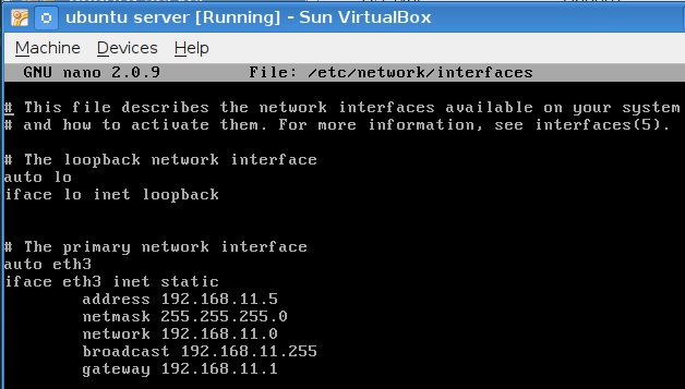

by: ussherPosted on 2009-09-21 at 14:16:40ID: 25387723
this is the contents of the /etc/network/interfaces on the virtual system
