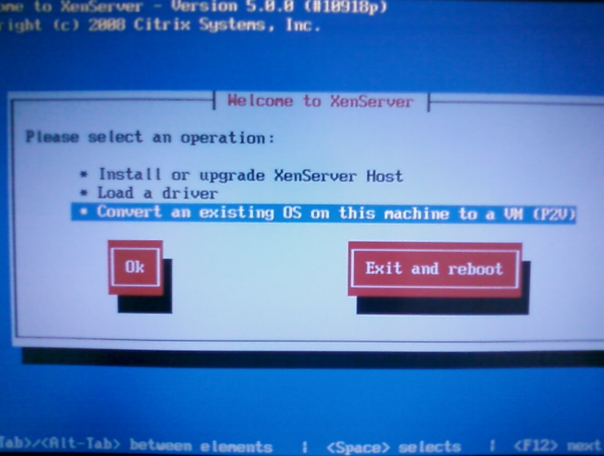

With Citrix XenServer Cd free downloaded from Citrix website you can Install the Hypervisor on the physical machine and with the same Cd you can import your physical server in a pre-installed XenServer by P2V procedure.
See the image I uploaded when you select the P2V operation.
by: ecszonePosted on 2009-01-22 at 07:37:07ID: 23440215
I was told that is just for linux based systems and not windows?
Of coarse I may never have mentioned we are a windows shop.

by: ecszonePosted on 2009-01-22 at 12:44:12ID: 23443436
Your right.
mycitrix / downloads / xenserver
act like your going to download xenserver 5
and you then can see xen convert.  This works with windows 32 bit or 64 bit.!
and free!
Thanks for everyones help.
by: ecszonePosted on 2009-01-22 at 12:45:36ID: 31537204
Xen Convert is what im lookikng for with the 3rd party options as a fall back method.
