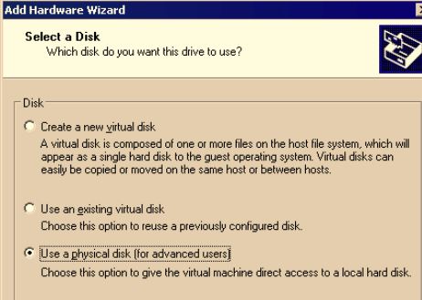

by: ryder0707Posted on 2009-09-08 at 21:42:45ID: 25288269
btw, while looking at my old docs i just realized, you could achieve what you plan to do with vmware server 1.0 not the latest 2.0
see below screenshot
    • 36 KB
    rdm with vmware server 1.x

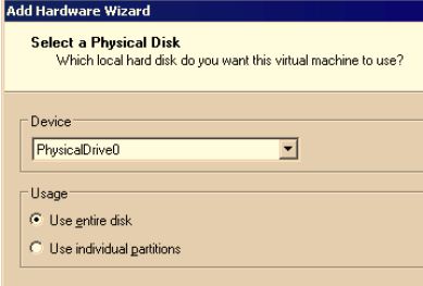

by: ryder0707Posted on 2009-09-08 at 21:43:53ID: 25288273
and this
by: eeshahidtPosted on 2009-09-08 at 22:20:10ID: 25288440
Yeah, that's what I wanted. I know KVM can do this and also VirtualBox (although unsupported). I just wanted a walkthrough from someone, since I couldn't figure it out myself.
by: ryder0707Posted on 2009-09-09 at 00:02:29ID: 25288818
Just register and download it from vmware, it is still available at http://www.vmware.com/download/server/getserver.html
