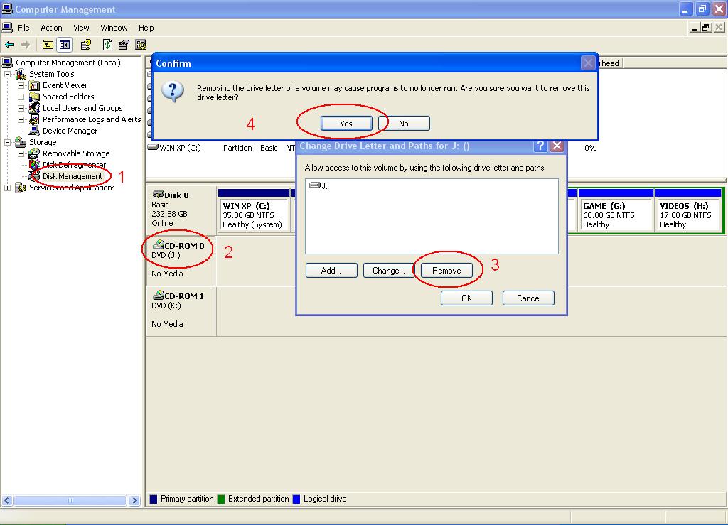

You can make it disappear by unallocating the drive letter that windows has automatically allocated to it, the process is as follows... Right click my computer -> manage -> u'll find the drive listed in right pane below, right click on the drive letter > "change drive letters and paths > Remove > say yes to the warning and close the window, now the drive must have disappeared from explorer....

by: humanonomicsPosted on 2008-03-20 at 08:41:10ID: 21172642
Guys thanks for all the help especially cool_sathish_333:, the solution worked exactly I wanted it to work :)
