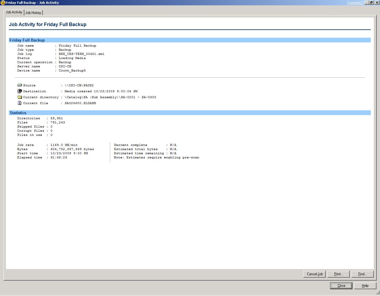

Loading media is where it tends to get stuck. It is currently in that state now from last Friday.

by: GambleSolutionsPosted on 2009-11-02 at 11:17:28ID: 31642271
Apparently there was an update out there that fixed the issue. It had to be uninstalled/reinstalled. Thanks! Backup of 629Gb only taking 13 hrs now opposed to 3 days.
