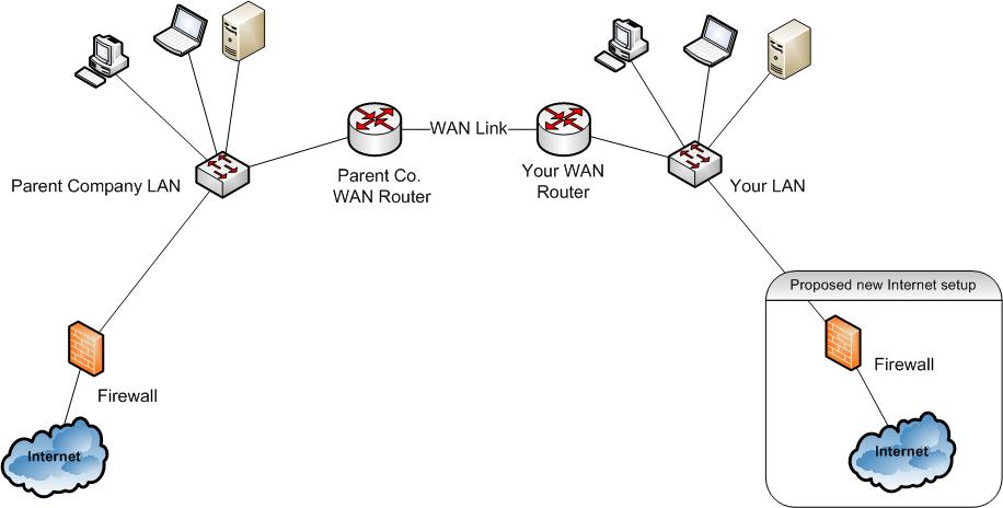

by: pwindellPosted on 2009-08-25 at 13:18:54ID: 25181797
Since I sometimes misunderstand someone's description in their question, here is a disgram of how I interpret your question and what you propose to do.

Hey, thanks for mapping that out and yes, thats pretty much what we have and what we would have liked on the proposed image. I guess i was thinking perhaps on a simplistic level in terms of switching web proxies on the browser alone (IE) without affecting the machines general parent provided net connection.... crucially we have a number of webapps that are becomming more important to us day to day. Perhaps even if I could setup the proxy to divert specific url requests through a specific connection this might be progress.
P.S on a different note, what app did you use to map out the diagram? could be very useful, thanks.
by: pwindellPosted on 2009-09-01 at 06:47:05ID: 25231501
I used Microsoft Office Visio 2007.
Anyway, if you do as the diagram shows,..then you need to:
1. Each LAN uses their own WAN Router as the default gateway of all their machines.
2. The WAN Router in each LAN uses the Firewall in the same LAN as its Default Gateway.  This may mean that it will also need a static route to make sure changing the DFG does not "break" the WAN connection.
Some firewalls can have more than one internal type nic which allows the WAN link to run between the two "third nics" of each firewall this simplifies routing.  My diagram does nto reflect this design.
3. Each Firewall is configured with a Static Route the tells it to use the WAN Router in that same LAN as the "path" to the opposite LAN.
4. Each Firewall must include the IP Range of Both LANs in its Local Addess Table (LAT).  Each brand of Firewall may have a different name that the LAT is called. You'll have to figure that out.
